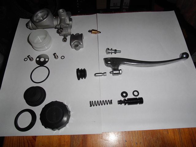

by MickeyMoto
Yes, it is tight. Try looking for something like a Laverda 500 splitter that fits on the bottom yoke.
Picture shows the tightness.
