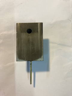

I'm bit surprised the bike is so sensitive to carb wear as older carbs on other bikes always started OK but were sometimes a bit rich. I've added an image of one of my carb slides here for your consideration! I do wonder about just buying new alternative carbs but don't know which I could use....Thanks once more!!
Following your advice I'm thinking of buying this lot below from Eurocarb- can anyone confirm correct? Ie Standard 350 Spor VHBZ 25 BS carb ...Not sure which slide-50 or 60...?
x2 9526 AP Type atomiser (VHB(Z) 20-26mm)
x2 2343 E type needle (VHB(Z) 20-26mm) - E17 needle
x2 7447 VHB VHBZ 20 – 26 Slide- 50 OR 60
- IMG_3683.jpeg (47.17 KiB) Viewed 7640 times
