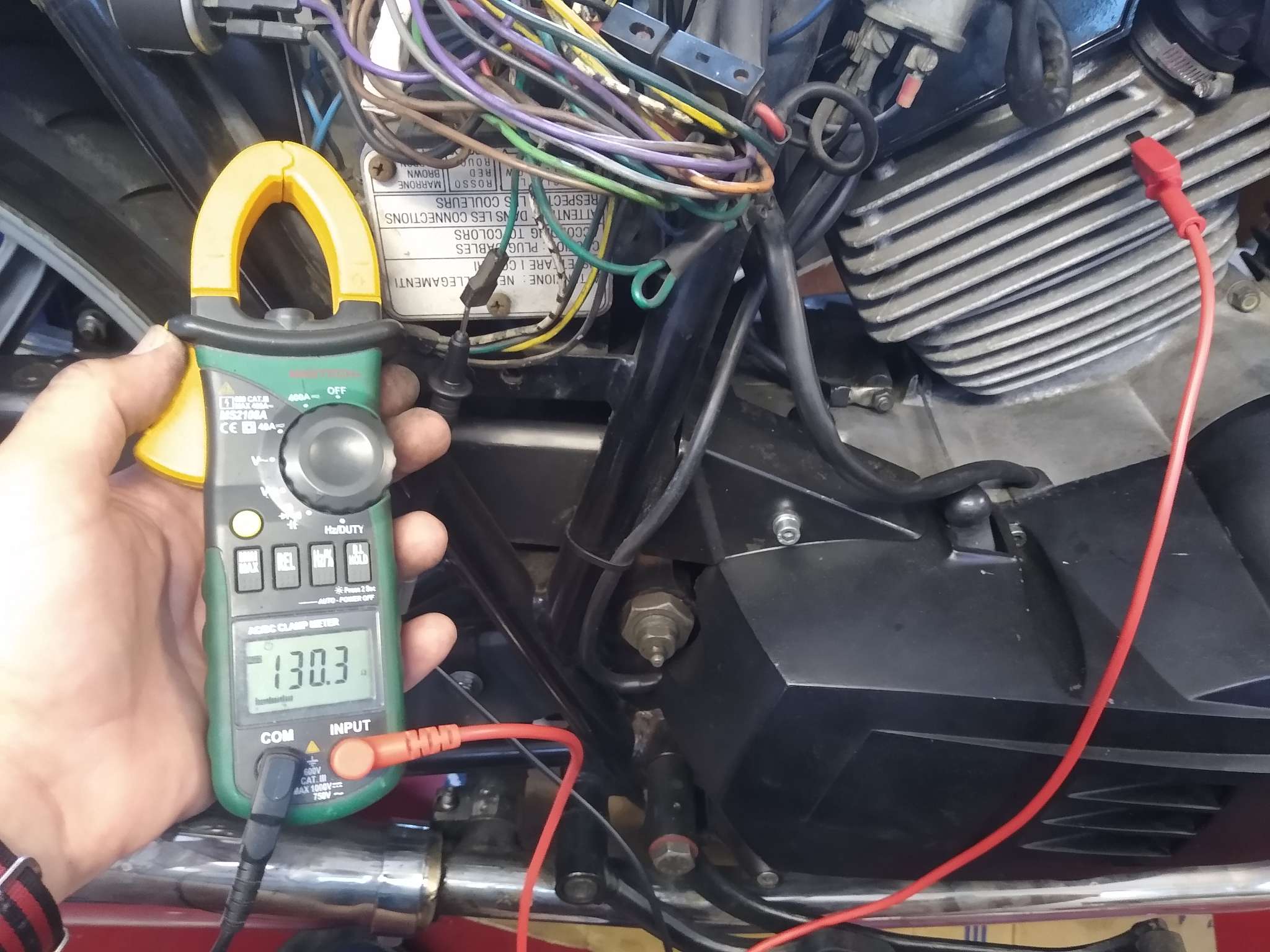

I have checked both spark plugs and they both have very weak weedy sparks. I have checked the resistance of the green wire from the generator as specified in fig 174 page 97 of the blue book. It should show 300 ohms but is only reading 130 ohms. The blue book just says replace stator if there's a low reading but doesn't say what a low reading is.

Ma experience is that starting problems begin with less than 170-180 ohm on the ignition coil/green wire. I´ve never had a coil with 300 ohm.
Re: Do I have an ignition problem
When I got my 350 it was not an easy starter but ran OK. The ignition coil gave a reading of around 175 ohms.
Post rewind it was in the upper 200’s. It then started easily.

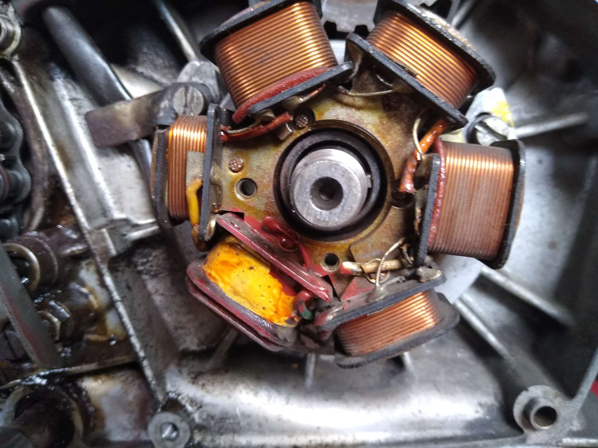

So I am a bit confused by the mention of coils. I thought I was testing the stator. I can't find mentions of coils only transducers.
I really struggle understanding electric and electronics it's like I have electric dyslexia. Give me a gearbox or a crankshaft and I am fine.
Do I need to replace or repair the stator or the transducer/coil
I was talking about the "ignition coil" of the stator. Normaly it´s the one that is wrapped in a yelloy plasic foil. From this coil goes the gren wire to the boxes under the tank via the central electric port under the right side cover. All the other coils of the stator don´t have any influence on the igninicion system

Ah got you in pictures I can see the ignition coil on the stator. It looks like I am going to have to get either a new stator or get mine rewound.norbert wrote: ↑10 Jul 2023 10:33 I was talking about the "ignition coil" of the stator. Normaly it´s the one that is wrapped in a yelloy plasic foil. From this coil goes the gren wire to the boxes under the tank via the central electric port under the right side cover. All the other coils of the stator don´t have any influence on the igninicion system

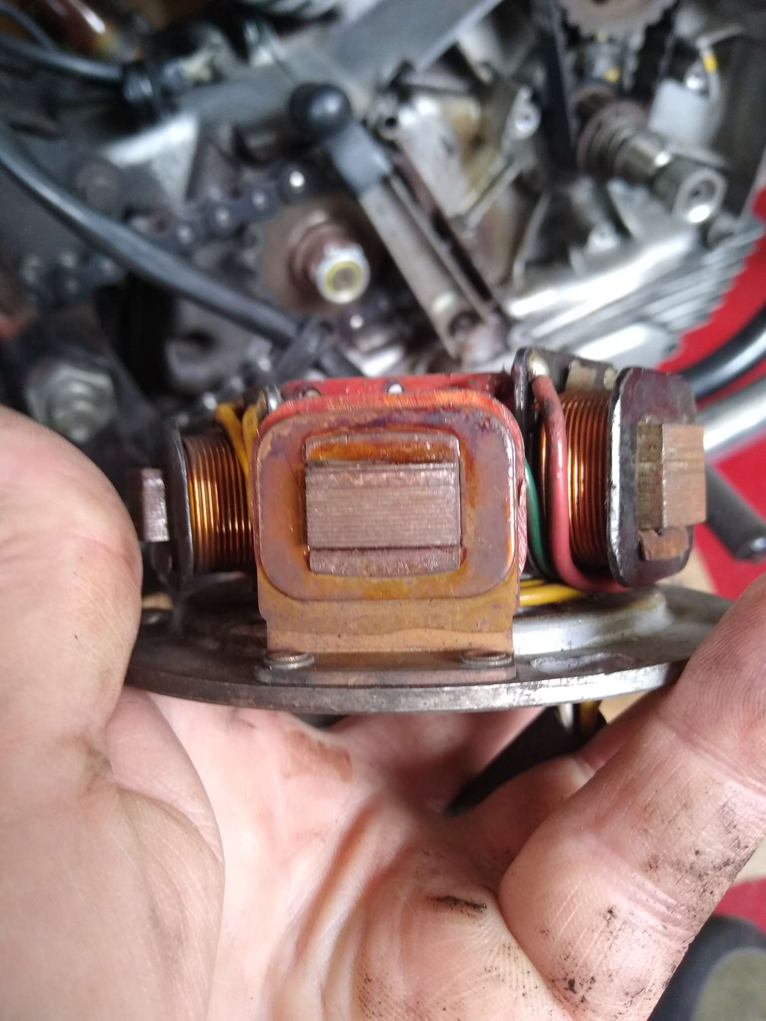

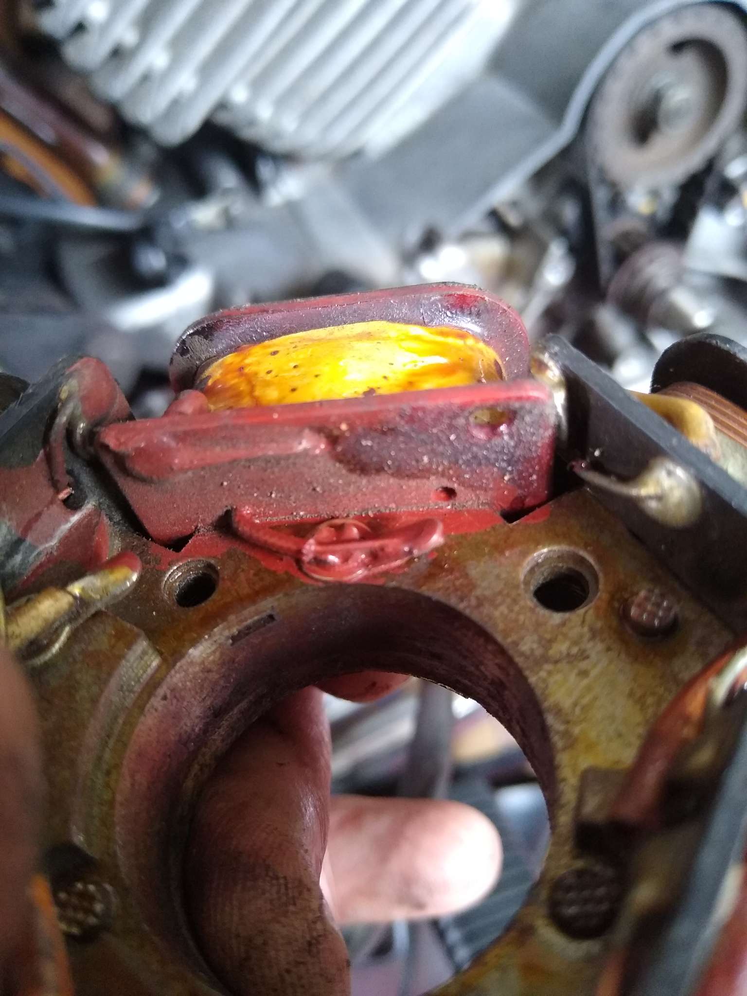

Ignition winding looks a bit manky but I can't see if the blue smoke has escaped. I will be sending it to Rex's speed shop when I get a response from them.
