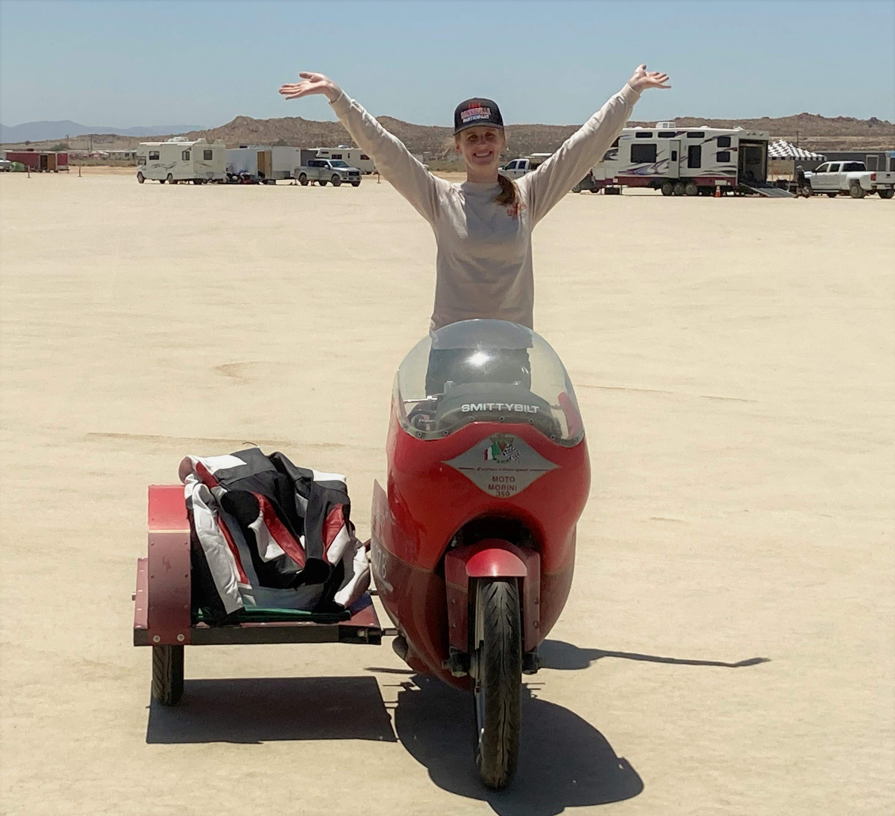

Hello All in the UK and elsewhere.
The Supercharged 350 Morini smashed a 50+ year old record at the El Mirage CA lakebed last Sunday by more than 10 mph with seeming ease .
Miss Amy, the pilot, celebrates back in the pits just before the post race inspection....
She and the Bike are heading to the Bonnieville Salt Flat in August to hopefully repeat the trick there
Wish us Luck!

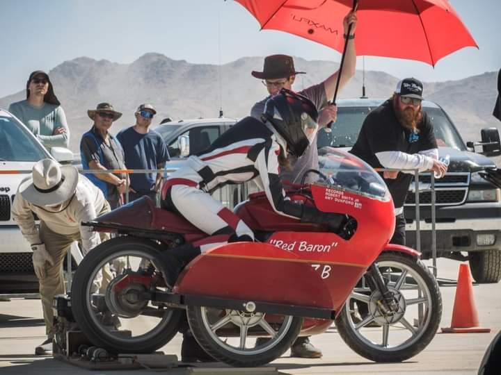

More Pictures:
The Startup Dance just before launch...
