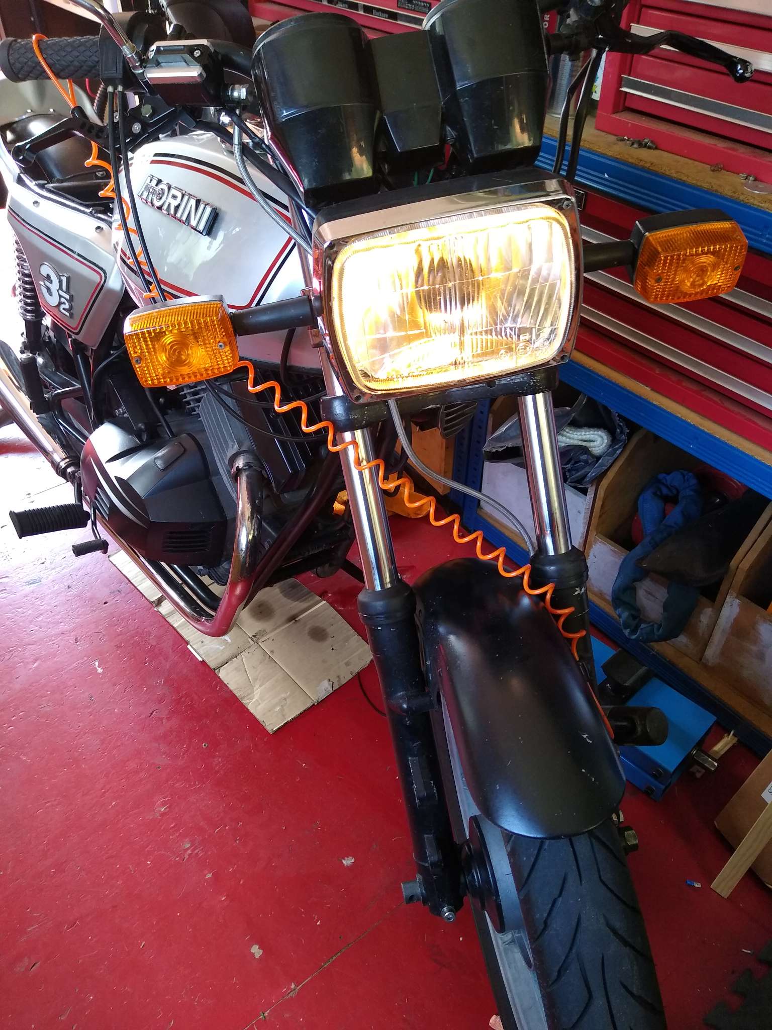

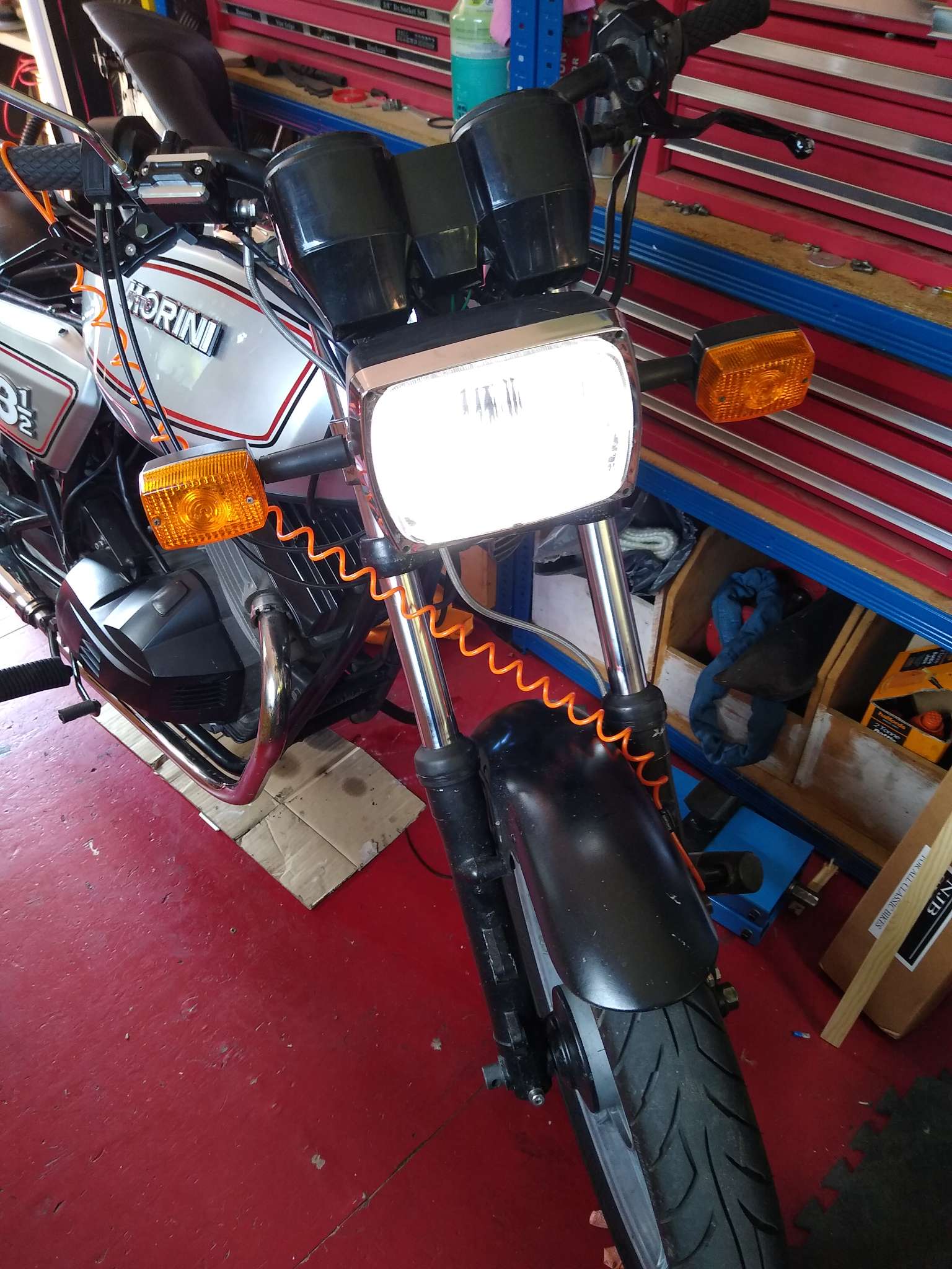

I finally got round to fitting the Paul Goff LED bulbs and nearly burnt my retinas
Before
After
Before
After
