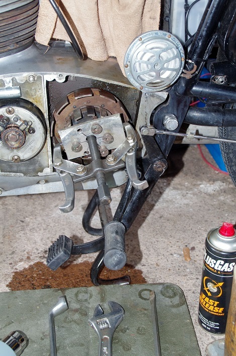

Going to get stuck in to stripping down one engine soon, so I will bear in mind it may need tweaking, though the trusty plate and strap are still in the 'special tools' drawer. At least you don't need a puller to get the hub off. Unlike the Gilera where I had to get inventive with a two leg puller and a piece of dural.
