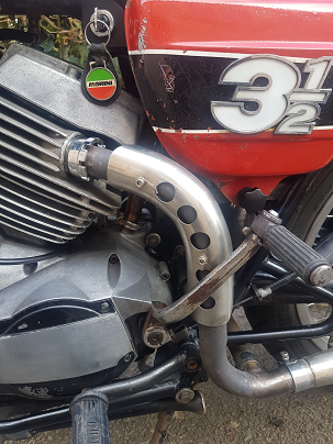

The round side panel goes with the shorter heatshield and for the strada the steel kick start with the crank at the top like this:
short heatshield.jpg (124.89 KiB) Viewed 9361 times

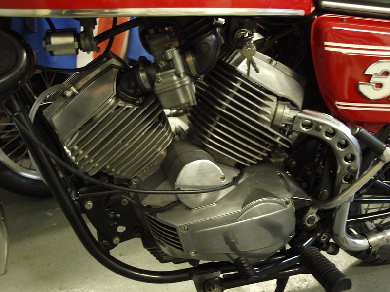

The angular side panels usually goes with the longer chrome or black heatshield (black is later models)
The kickstarter is either steel crank at the top or aluminium crank at the bottom.
Like this 1979MY strada
Note that any combination of heatshields and kickstarters can be found as "original", so correct doesn't really mean much to Moto Morini as you will find out from this forum. The aluminium kickstart was used on Sports earlier, and the steel top crank type were used on 250s until the very end of production in 84 and the factory was always in the mode of using what was available to ensure production output was met.

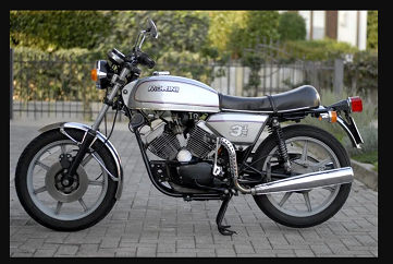

There is also the K2 kickstart which is cranked at the bottom
And 83 strada with this kick start, long black heatshield, on this topic

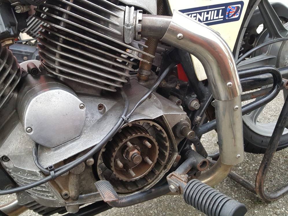

My alternative solution to the heat shield issue, albeit on a 2:1 system on a 350 in a 250, is two lengths of stainless exhaust split lengthways. One came as a nearly perfect 'bend'. Held on with screws in to stainless jubilee clips. Crude, perhaps, but effective.

This heatshield was made for the MRC club strada by Paul Compton by slitting a stainless pipe with the appropriate bend
the holes were added by Benjy Straw. I think Paul has a youtube video showing how he did it. https://www.youtube.com/user/EVguru
