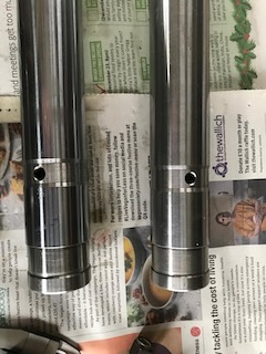

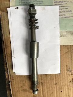

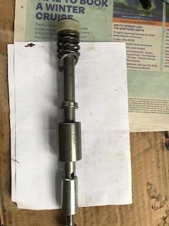

Can you assist me on fork internals..whether correct or OK damping set up..it's actually for a friend who wants them on his Egli Vincent...There are different set ups on each fork which may be correct or OK to use [eg Maxton offer diff on each leg- one for rebound and one for damping]...Perhaps these are an early version of this? He just wants to use on the road and know they are safe.
Please see tech pics here and Q's below--very many thanks for any of your time on this !
Q1.Do you recognise the damping arrangements? Are all the components there?
Q2. Should the bottom of these tubes have a bush on them?
Q3. Oil recommendation ?
many thanks !!- matt

- Fork leg 1 Marzo
- d4021439-7612-4b6b-896f-3837b6922a16.jpeg (25.7 KiB) Viewed 2429 times
- x2 tube bottom ends
- ad3e7453-0401-4a75-992e-b0aedd6b2b14.jpeg (35.07 KiB) Viewed 2429 times
- Fork leg 2 Marzo
- 945a17ca-e3de-4ade-a558-cfa476102453.jpeg (25.87 KiB) Viewed 2429 times
