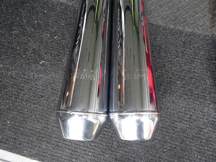

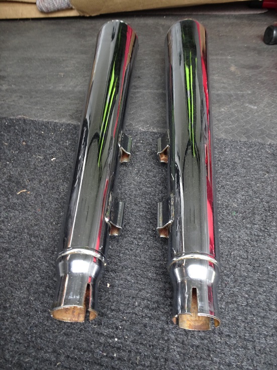

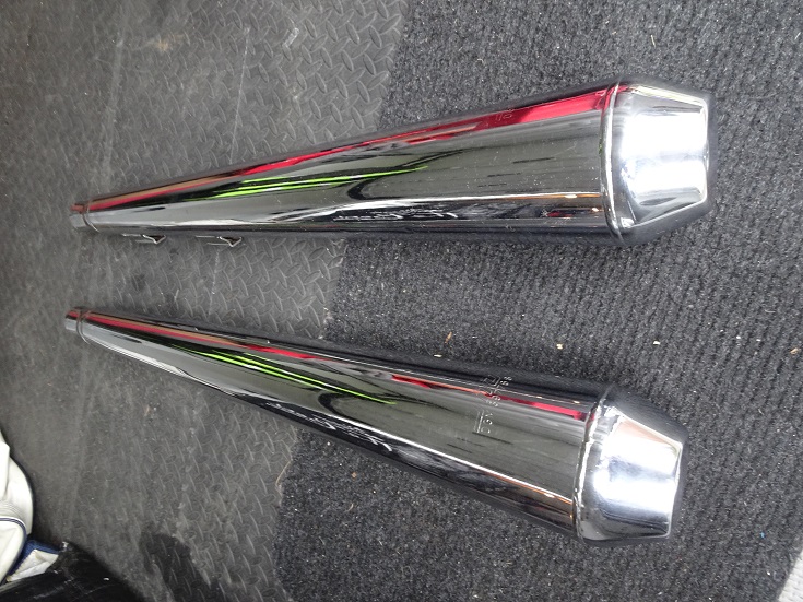

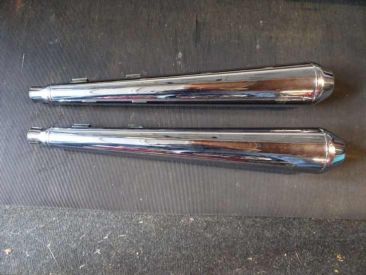

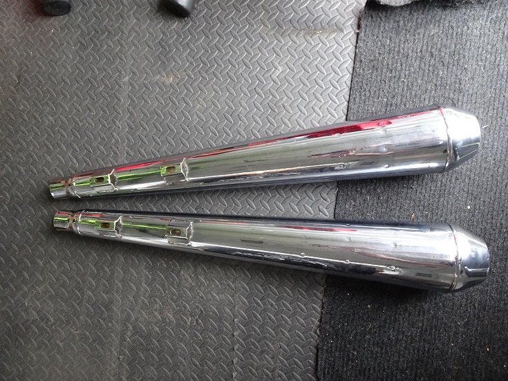

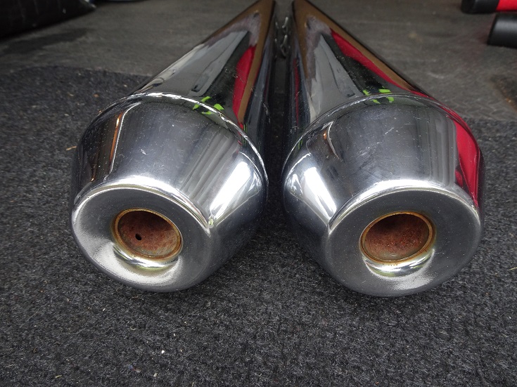

I have a pair of chrome Sito silencers that I would be willing to part with. (See photos). Some very light pitting on the surface and some light rust inside but not enough to worry about.
As George 350 said, you can end up chasing your tail with 'universal' silencers and once you've sorted out reducers (and some sellers are incapable of measuring things properly) you may end up with something that looks rubbish and is just as loud as the system you already have. The Armours silencers look nice but are a fair bit louder than standard.
I don't have the clamps and mounting brackets for these silencers, but if you can source the stock downpipes and fittings, these silencers will fit straight on, will look the part, and will be no louder than any standard 3 1/2 Morini.
The silencers are located in Warwickshire and I'm not keen to post them but would be willing to meet you at the M40 Oxford Services to hand them over. Price-wise I'd be looking for £120 the pair at Oxford or £100 the pair collected from Warwickshire, postcode CV8. Let me know if you are interested. Here are the photos...
