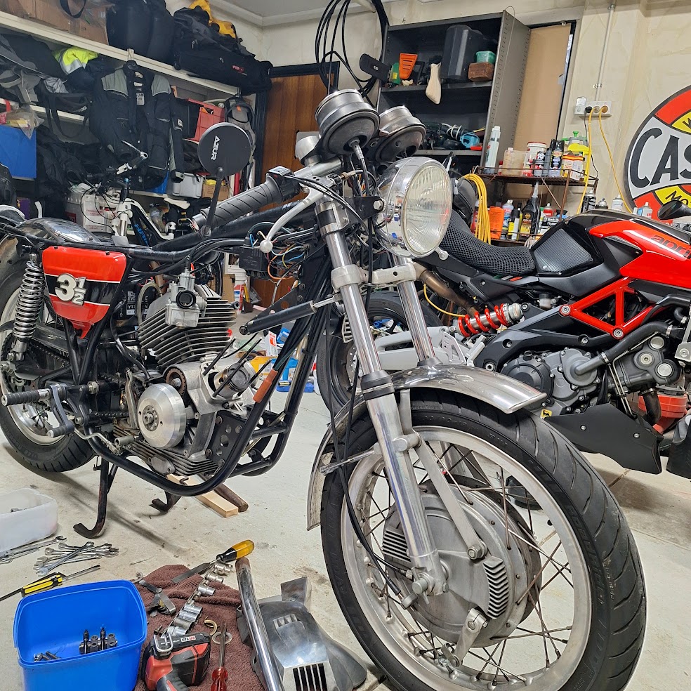

All done. Took 3-4 hrs and now completely oil tight.
