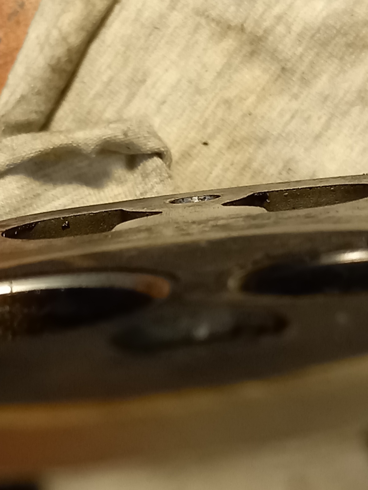

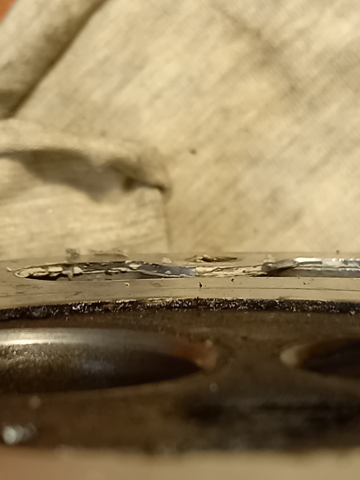

Morning All,
just working on morini This möring and just took valves out of heads to clean up and noticed they are different one is completely flush with gasket face other is roughly 1mm recessed obviously this will affect compression so which one is correct ?, should I skim the other one off or look for another head, also how much clearance is there before the valves hit?
Thanks Chris

Or, complete guess, is there an old alloy head gasket stuck to the head? I imagine that would be obvious though, and the head still flat. Is the piston the same as the other one?

Thanks again for reply, can’t believe I didn’t put pics up thought I had any I will do them now sorry I haven’t quite explained this properly it’s not a dome but a recess, pictures are not great angle but you should see the carboon the recess of the one the other is flat
Thanks again

Are you sure it’s not just an aluminium head gasket still stuck to the head?

Im 99% certain it’s not, BUT, you have both mentioned this so I need to take another look tomorrow as you have now made me doubt myself, I have a nasty feeling I’m going feel an idiot by this
Thanks anyway, will let you know either way Tomorrow morning

I am 100% convinced that is an alloy head gasket bonded to the head. I was secretly hoping you'd discovered the fabled low comp trial special heads from the works comp department. Bugger.

However, if you look at ghe two heads, ignoring the gasket, is not one valve seat 1mm lower in the head than the other head? The one with what looks like a crack in the seat.

Right, update on this, as you were probably expecting you were both right, had I examined my own pictures and looked properly at the head it was then clear to see it was an aluminium gasket stuck to the head, Thanks you both for pointing this out.
As for the crack I have just rushed into my garage and got it under my magnifying light and it must have been a bit of carbon or something that made it look like a crack as it’s no longer there having wiped around the seats with a brake cleaner soaked rag,I have looked at the picture and identified the spot and gone over it 3 times now and there is definitely no signs of a crack,
again Thanks for highlighting what looked like a potential problem

There is one thing actually,my bit of advice, study your own pictures before you post them 2 mistakes Ist mistake 3 pictures are the same and 2nd didn’t study what the picture showed
