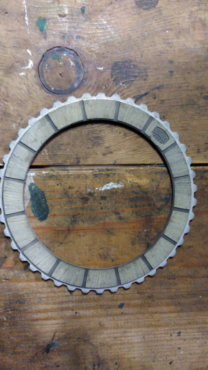

Anybody recognise this? It's the same size as a regular 31/2 clutch friction plate. It was in a bunch of Morini parts we recently bought. So we would like to understand what it fits.

501 ? Later model 350 ?

With outer teeth like that it’s not any of the air cooled dry clutch vee twins. Later 350 and 500 clutches were basically the same as the earlier ones,

Based on the information available this appears to be a brand new friction plate from a 250 Single.

A 250T clutch plate has inside diameter 9.5cm. Does it have friction material on both sides? If not, it is the special half-plate of which there is only 1 in a set. If both sides, you need another 6 to go with it.

davel182 wrote: 18 Feb 2025 20:11 A 250T clutch plate has inside diameter 9.5cm.
Yes it is 9.5cm inside diameter.
Yes it has friction material on both sides.
I have a total of 5 brand new, but they don't fit my 3½. So probably they are for sale sometime soon.
