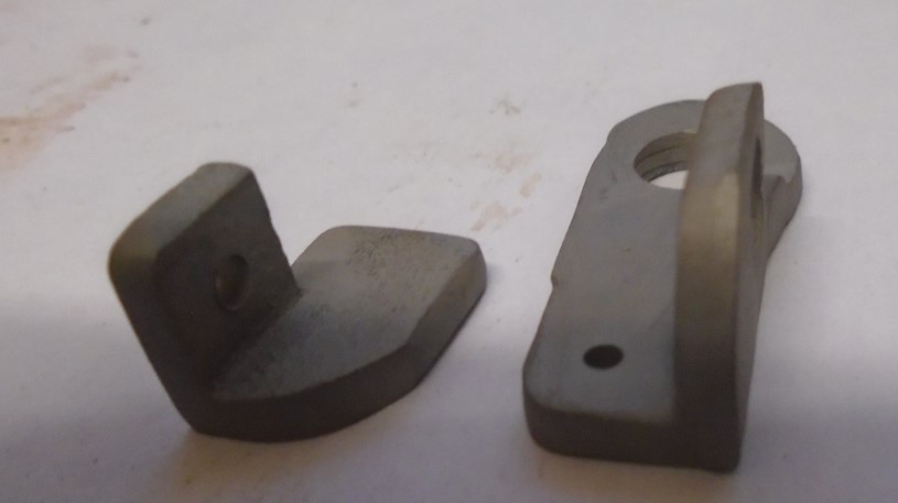

A search of ebay found a small brakelight switch that I thought would be suitable so I ordered one. Once it arrived I was able to plan how to mount it. Here are the 2 brackets I made. The left-hand one is the stop to go on the lever to release/compress the switch plunger and the other is to go onto the lever mount to hold the switch.
Brackets
Brackets

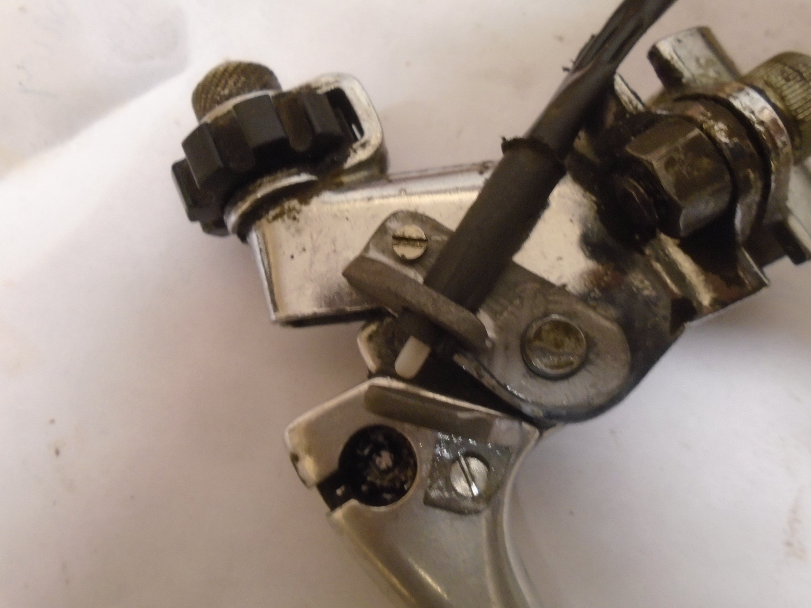

There isn't much force needed to operate the switch so I kept the mounting screws as small as possible. I used 6BA screws (2.8mm diameter) as I had some handy and the thread is very fine which is ideal for using on the thin metal of the lever mount. As you can see in the following picture the switch mount is also held by the locknut for the lever pivot. That complicated matters slightly as to get the angle of the switch right in relation to the stop I couldn't make the bracket out of a stright bit of angle iron, I had to make it in 2 bits and weld them together.
Brackets and switch mounted
042 compressed.jpg (462.41 KiB) Viewed 4334 times

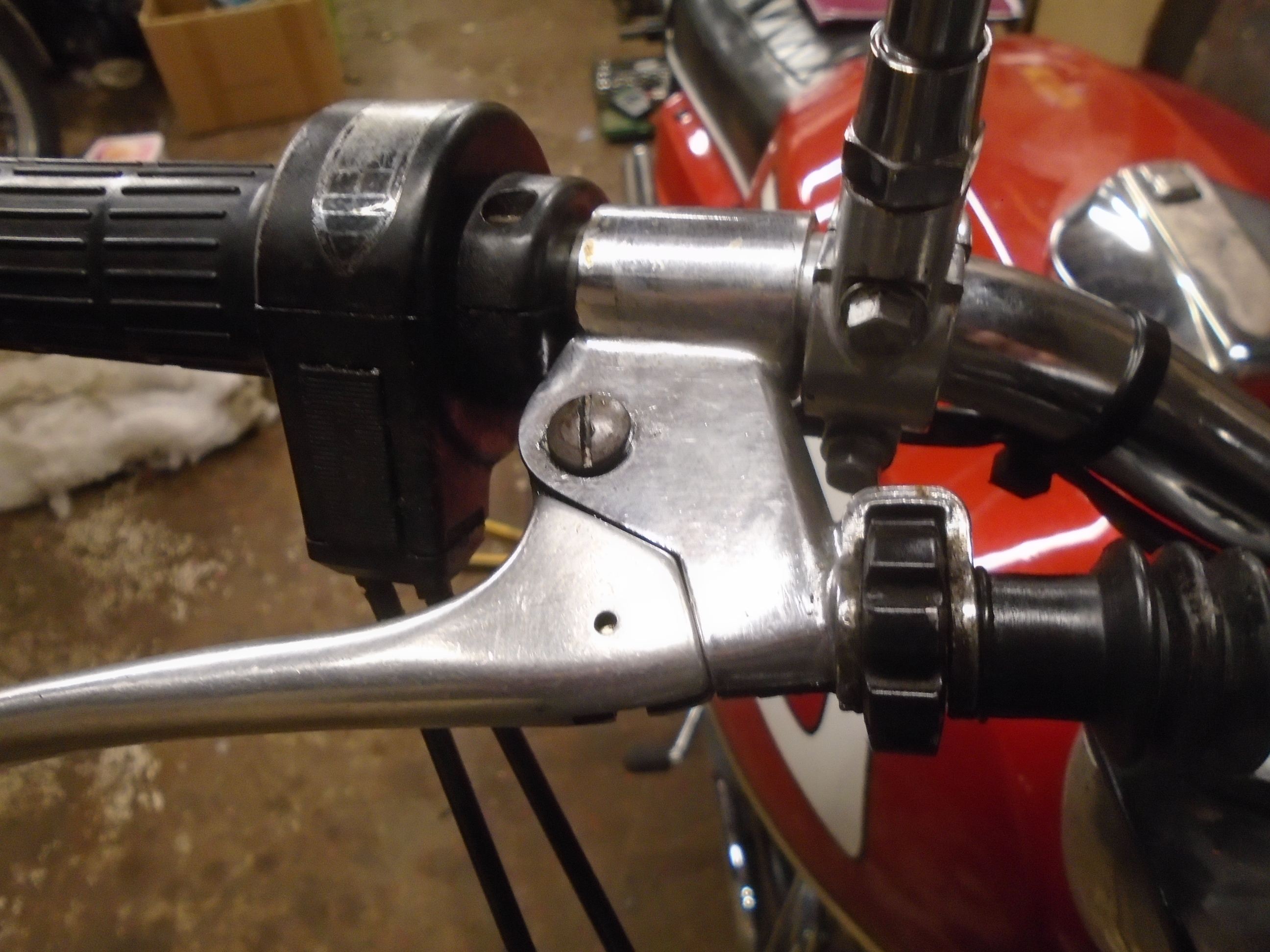

It all worked out brilliantly. The 6BA held the stop firmly enough although to make absolutely sure it won't move I added some sealant to help glue it to the lever. At some point I will make a slightly longer pivot bolt as the thread now only goes halfway into the locknut. I ran out of time to do that now so simply used some loctite on the nut to help hold it. As you can see from the final picture the switch doesn't show at all, the only give-away being the cable secured to handlebar. An afternoon well spent I felt.
Switch not visible
Switch not visible
045 compressed.jpg (475.58 KiB) Viewed 4334 times

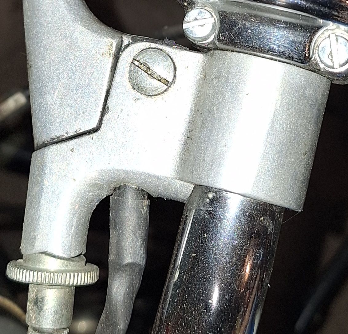

For my Norton I used the same type of switch as you have - around 6mm diameter - but judged that the brake lever support was robust enough to take a 6mm hole through the mount so that the switch is operated directly by the lever.
5 years on and it's still there and working as expected.
