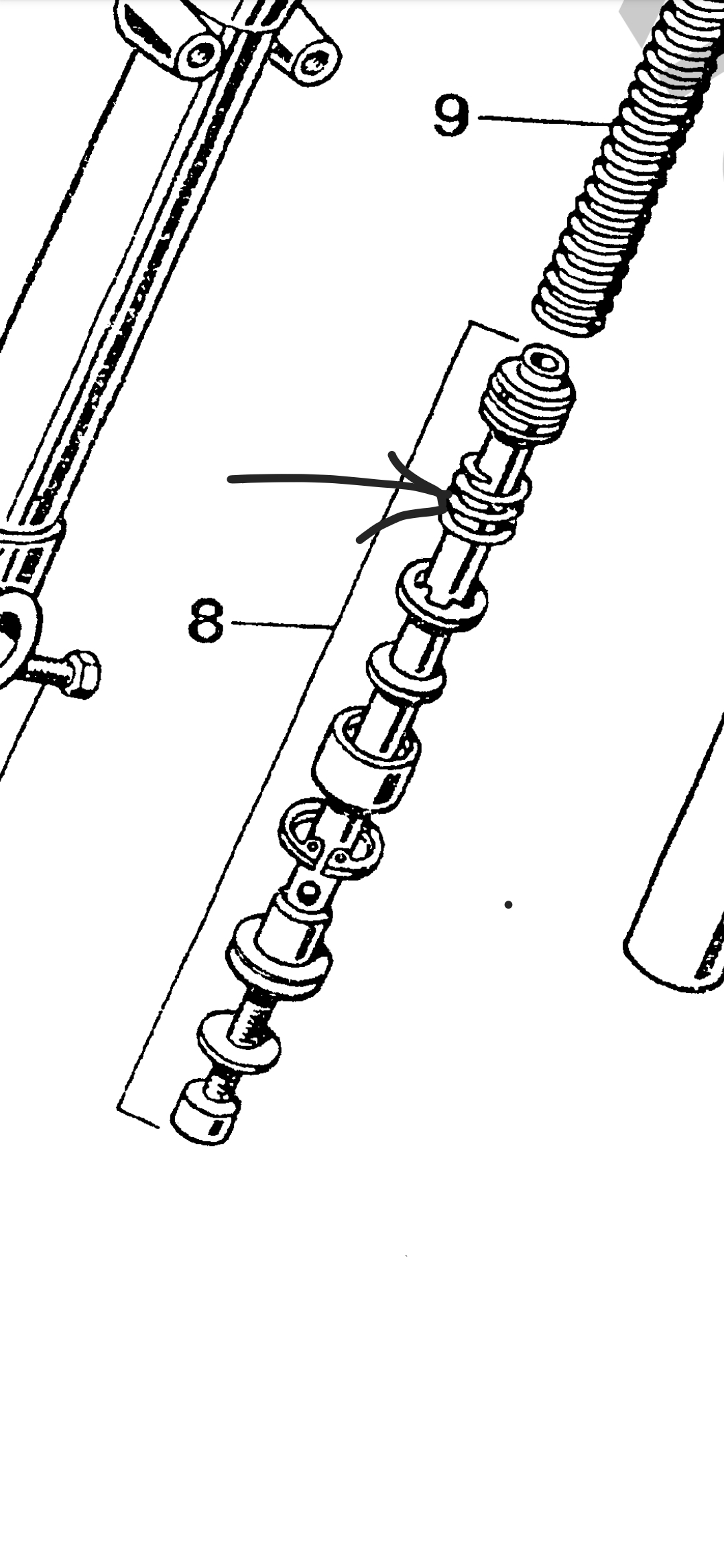

Hi Brian,
Unfortunately there isn't an 'exploded diagram' of the early Marzocchi forks in the Morini parts list, but the later forks have a small spring between the damper bush and damper piston that allows a softening of the topping out action.
See:
and the spring arrowed. The Paioli forks also have something similar.
Do your forks have this? Does anyone know if there should be something similar on earlier Marzocchis? If it is there, has it been assembled in the correct order?
If there should be a spring and yours were missing or below the bush instead of above, then it might well be the cause of your issue.
Just a thought,
