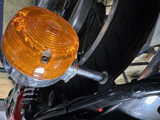

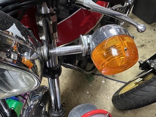

It was a bit variable on the earliest bikes as they were not standard fitment, and positioning of the bracket for the rears in particular can be a bit hit and miss.
I believe my ‘75 were factory fitted as the bike has never been repainted and the brackets look original.
Front stems just go straight through the headlamp in place of its mounting bolts.
Repros of the early, rounded back style CEV indicators are available, which I think are correct for a ‘76. They are quite fragile as the mounting screw of done up too tight or if the indicator takes a whack tends to crack the housing. Some sort of metal insert or strengthening plate/internal rubber mount could be made up and would be an excellent product.
These are the repros bought in the past:
https://www.ebay.co.uk/itm/253479089186
Stems shouldn’t be too hard to find or to turn on a lathe.
My front stems measure 14mm OD, 56mm between headlamp bracket and indicator body (ie the stem is 56mm plus thread lengths whatever they are), and at one end is milled a flat along 5.5mm length of the stem, and the thickness between the flats is 9.5mm.
The rears are the same but the stems are 52mm plus threads
