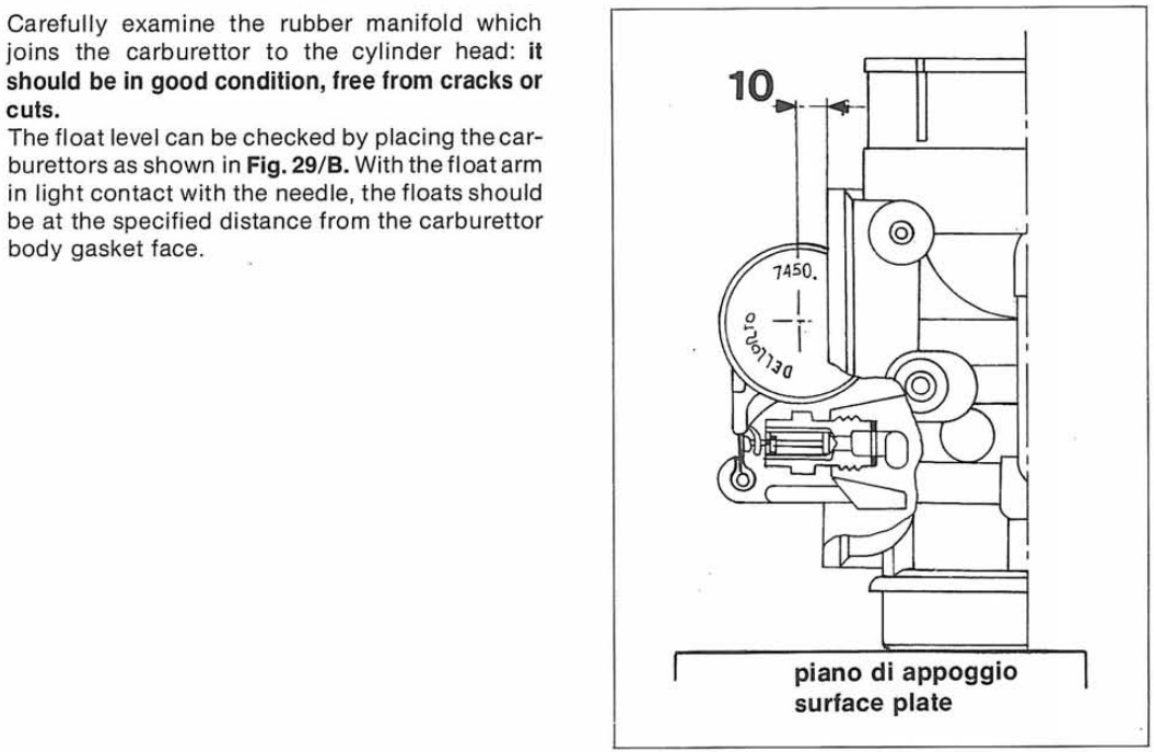

This is the picture in 'The Blue Book'...
Float height.jpg (120.72 KiB) Viewed 1103 times

One thing to note is that the measurement is taken with the float arm 'lightly contacting the needle' as shown above.
