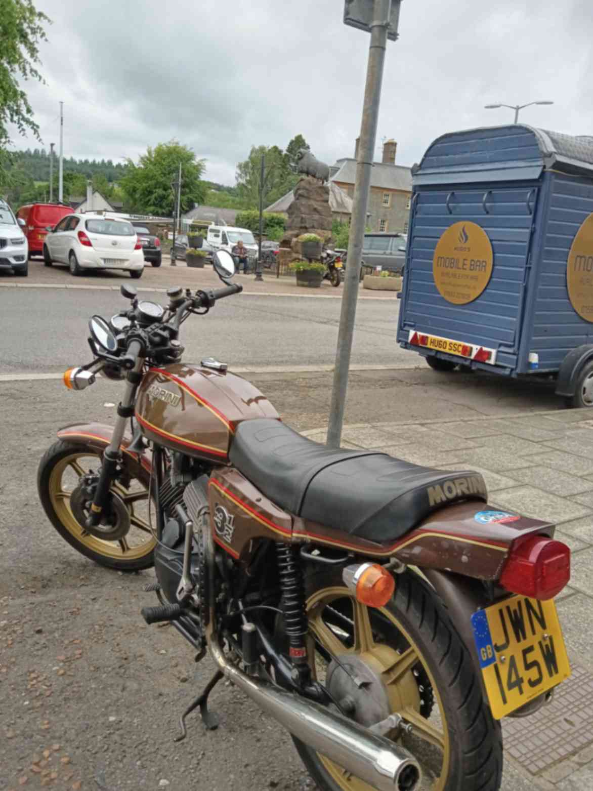

I fitted bar end mirrors. They vibrate a lot less than handlebar mirrors and I can see more road behind. Some are available that fold up if you need the space, as they do make the bike wider.
- jpeg-optimizer_IMG_20250625_115910.jpg (99.62 KiB) Viewed 2024 times
