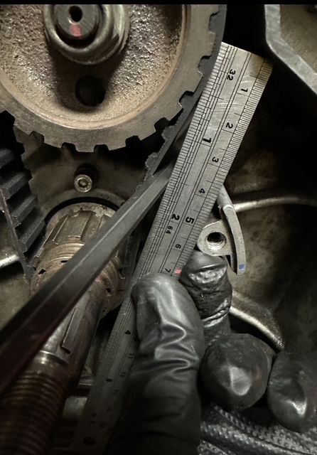

I’ve had a few belts recently which have not been a great fit on the pulleys- either too loose or too tight. If too tight they tend to whine and it’s particularly noticeable if you rev in neutral you’ll hear it whine on the overrun.
If you bought a graded C belt from Mdina then of course the fit should be perfect but don’t rule out wear in the pulleys over the last 40-50 years which could change the tolerance so it’s always best to still check the slack in the belt, as described in the blue book.
I find that placing a straight edge between the pulleys along the belt and then pushing an Allen key in between the edge and the belt is a good way to measure slack without any special tools. In my experience a 4mm Allen key is about right, a 3mm will whine and a 5mm will be too loose
- Posts: 1093
- Joined: 05 May 2006 13:47
Re: Timing belt question
Measuring belt slack. Bear in mind that there will be differences in tension depending on where the cam is so always rotate the engine clockwise a couple of times by hand and align the timing marks before measuring for mists consistency.
- IMG_2012.jpeg (196 KiB) Viewed 4820 times
