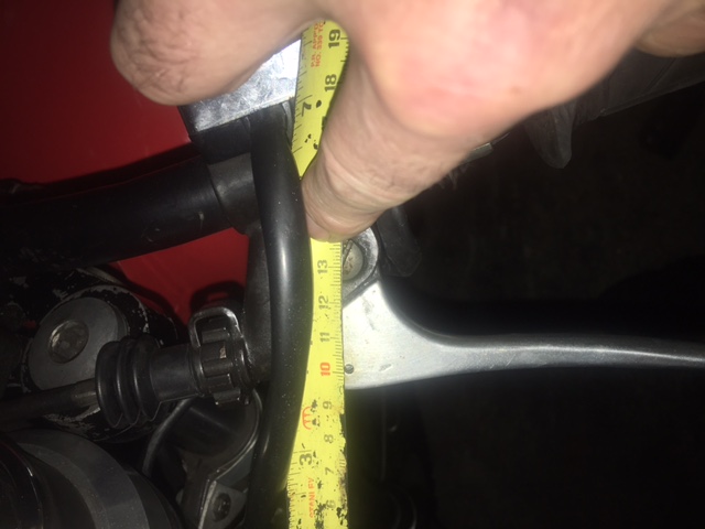

Posts: 13
Joined: 13 Aug 2019 15:52
Location: Ashford
Re: Clutch lever fulcrum
Post by GHF »
Clutch
Clutch
Hope this helps
