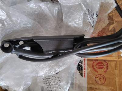

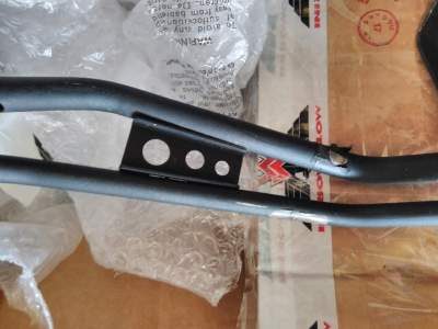

Mine fractured and got itself wrapped around the rear hugger.
I know of another that fractured in the same place and deposited itself in the road.
There is a modified part which is now fitted.
I urge anybody with a Milano to ask the supplying dealer for the modified part.
Easy to fit.
Top picture shows modified arm against old arm (showing the fractures at the end of the arm).
Middle shows the modified arm
The lower is the unmodified part.
