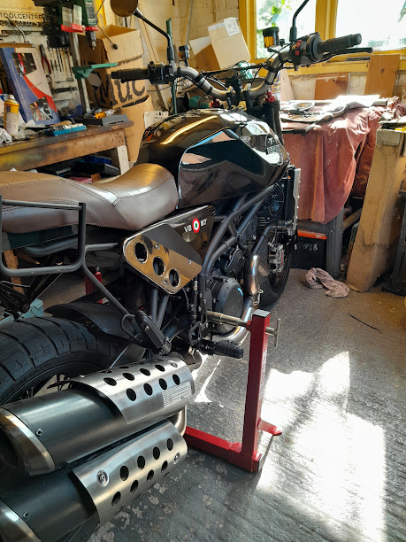

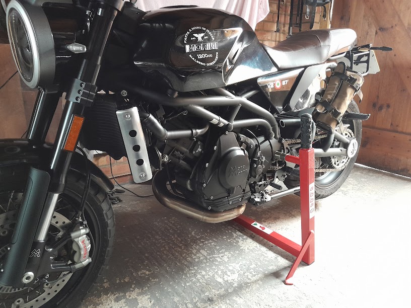

For the 1200 Milano and Superscrambler the mighty ABBA stand can be used, whilst it is not listed on ABBAs fitment list,
all that is needed is fitting kit 063 (which is actually the same as X-cape 650 although sides are swapped)
No more struggling with wonky paddock stands. These are rock solid. Backwheel can be removed easily and
importantly wheel spindle can be removed without need to remove the silencers, brilliant!
Front wheel easy too just a small jack under the engine to tilt the whole back or ABBA can supply another arm to lift the front.
ABBA stands can be found on the internet buy direct www.abbastands.co.uk - call them up to check your swing arm fittings and
order the special fitting kit.
ABBA stand Left
ABBA stand Left
ABBA stand right
ABBA stand right
Cheers Mark

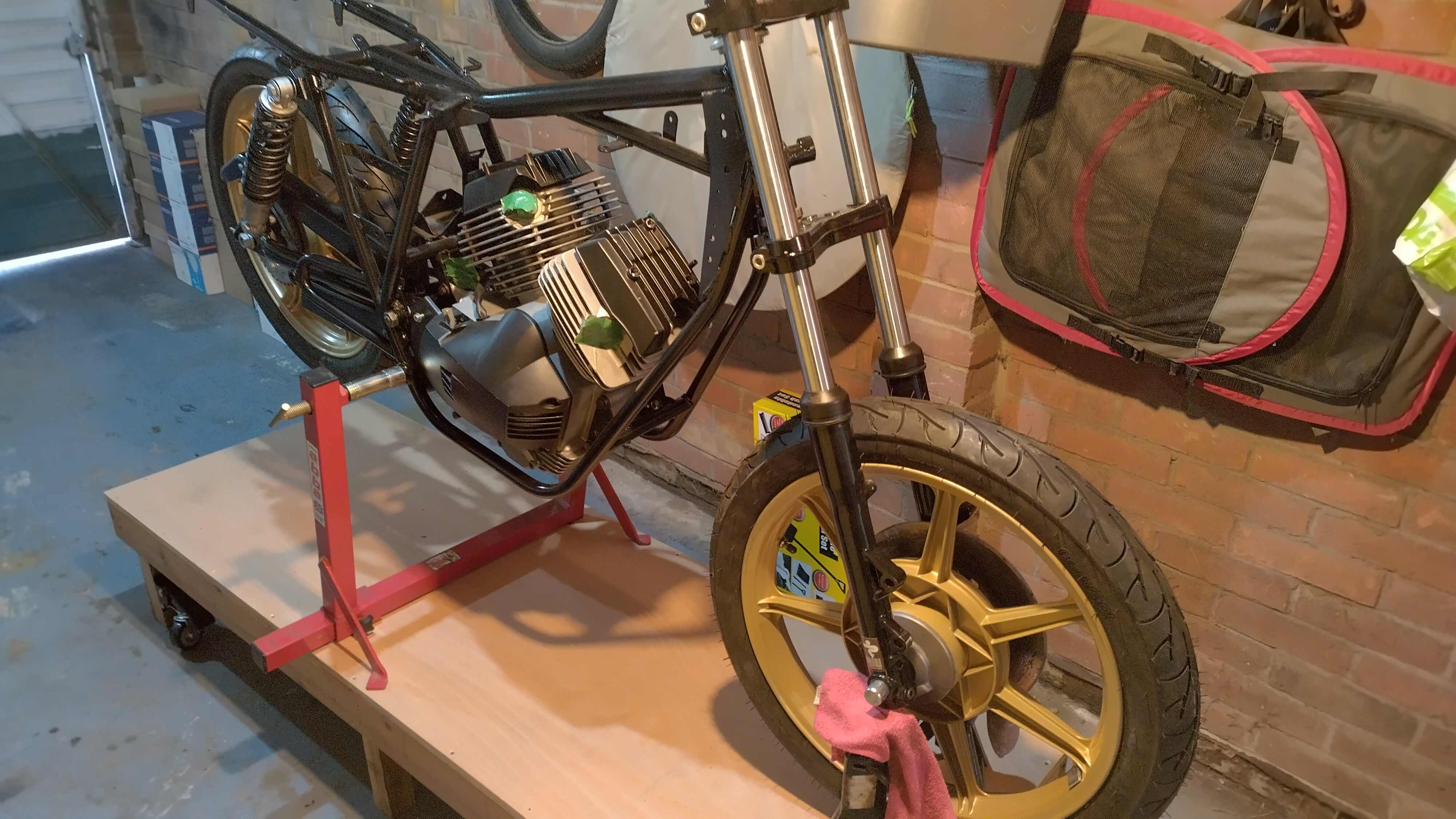

I have used an Abba stand for many bikes over a number of years. As you say a game changer. If you have a lathe, or friend with one, I have found it very easy to turn up adapters for different bikes, even my 250 (a bit high when using the footrest bosses).
20240213_141549 on abba stand.jpg (487.65 KiB) Viewed 9590 times
