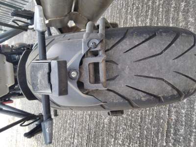

Oh, and rear number plate fell off. There is very little metal on the bracket holding the plate assembly, and it fractured going over a cattle grid. I have modified it and hopefully it will be OK now. It needs a strap from the mudguard arm bolt to the bolt holding the mudguard lower. The metal fractured, the plastic split and the whole thing fell off, narrowly being missed by my mate behind. I carry locking wire, cable ties and a pair of cutters now, so was a simple case of attaching the plate to my pannier.
I can't work out how to turn the photo!

Hi Mike,
That's a mess and thanks for the heads up.
Possibly the stupid wind sail we have to have in the UK is the culprit here. It flexes too much?
A light and smaller aluminium one as per the standard Italian plate might be better?

It does seem to be a recurring problem. Morini have fitted different versions since the first version. Was there an intermediate rubber mounted plate between the steel arm and the plastic "slate" ?
Would love to see a photo of what you have done to fix it

Honestly, you do not want to see how it is temporarily fixed. The number plate was attached to a metal plate that is attached to the mudguard which attaches to the piece of broken metal. So the holder was not fixed directly to the arm
When I get back I'll take some photos. Then I'll contact the importers...
