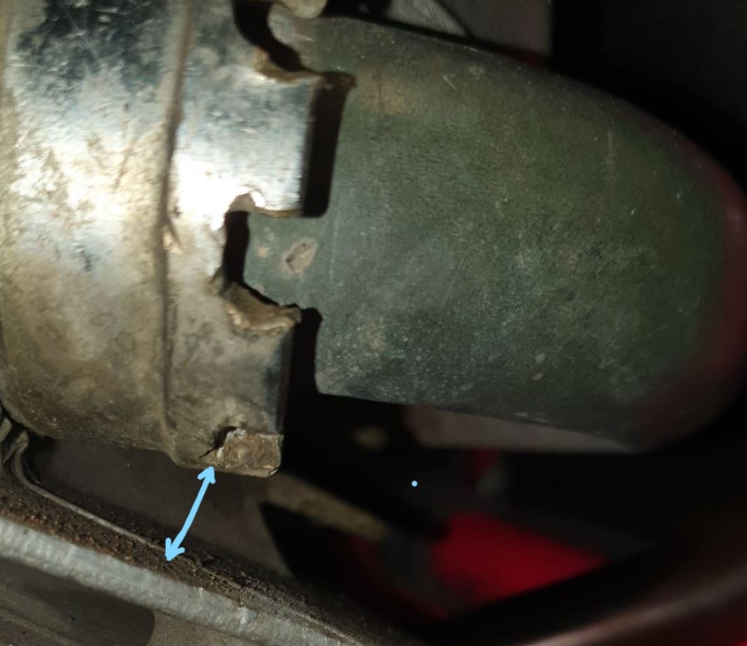

Hi Stempy,
Here's a picture of one of my mangled nuts (queue the carry on jokes)..
Blue line = 8mm
Blue line = 8mm
Exhaust nut_1.JPG (94.72 KiB) Viewed 6216 times
The blue line is a maximum of 8mm I would say.
Hope that helps,
Kamel.

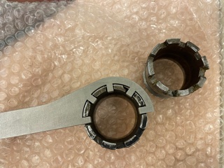

Post by Stempy »
Spanner back from the laser cutters ,will send back to Steve for approval :D
