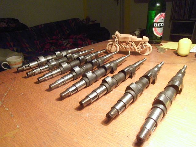

A lot of people said that the L and L5 both were marked only with L. But there are cams marked with L5!
I allways thought that the 501 from the Camel Electric Start has a L5. But when I had to open the motor a few years ago there was only a L on the cam :roll: A friend of mine opened two 501 from the Coguaro and found ...L :roll:
I still wonder where the L5 I had in my hands some years ago do come from :?:

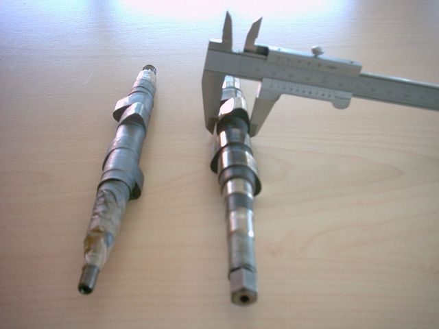

It is posible to change a 350 cam (sport or strada) to an L5. It´s not possible to do the same starting with a 500 cam, because you need the bigger "groundcircle" of the 350 cam to achieve the Lift of 5,95/5,65
Last two times we spent about 100-120 € for each cam, giving them about 10 units.

Looks like camshaft heaven to me Norbert :D
