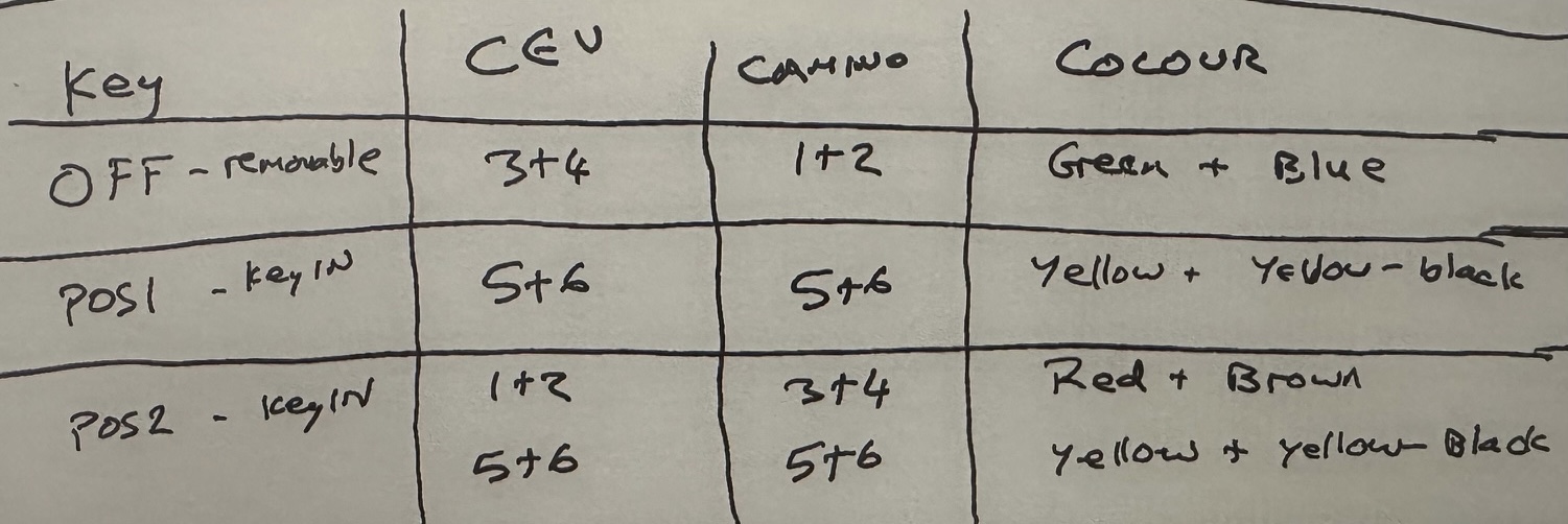

That's useful to know, Tom. I don't suppose you have a diagram or list of what connects where, for my man?

Safest thing to do is to do a continuity check of your existing switch positions against all pins in turn, but for me the below mapping of what is connected in each position for CEV to Camino switches and wire colours is what I ended up with. Position 1 is the redundant one.
Fundamentally, green should only ever be disconnected or connected to earth.
