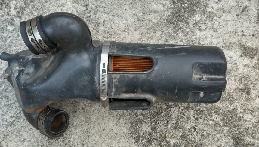

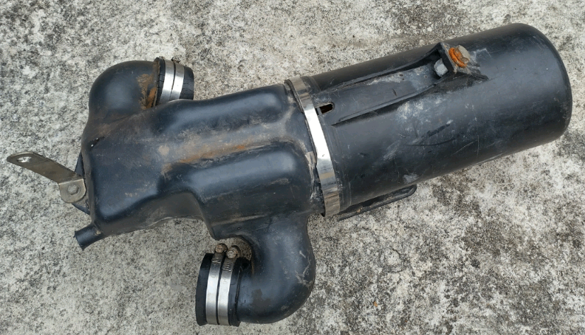

Hi there,
I have a 501 airbox. It's likely the same. Complete with filter. It is a round barrel type airbox if that helps describe it.
Hope this helps.
Posts: 1580
Re: Camel500 Air Box
Wassuck wrote: 13 Jun 2025 16:55 Hi there,
Hope this helps.
Sadly that won't fit-it's for the monoshock frames and there isn't anything like the space available to get it in there.
Some people have fitted a 350 airbox to the 500's and I haven't heard them complain about it. It's likely to be as good as standard till you want to go full throttle for 5 miles!
