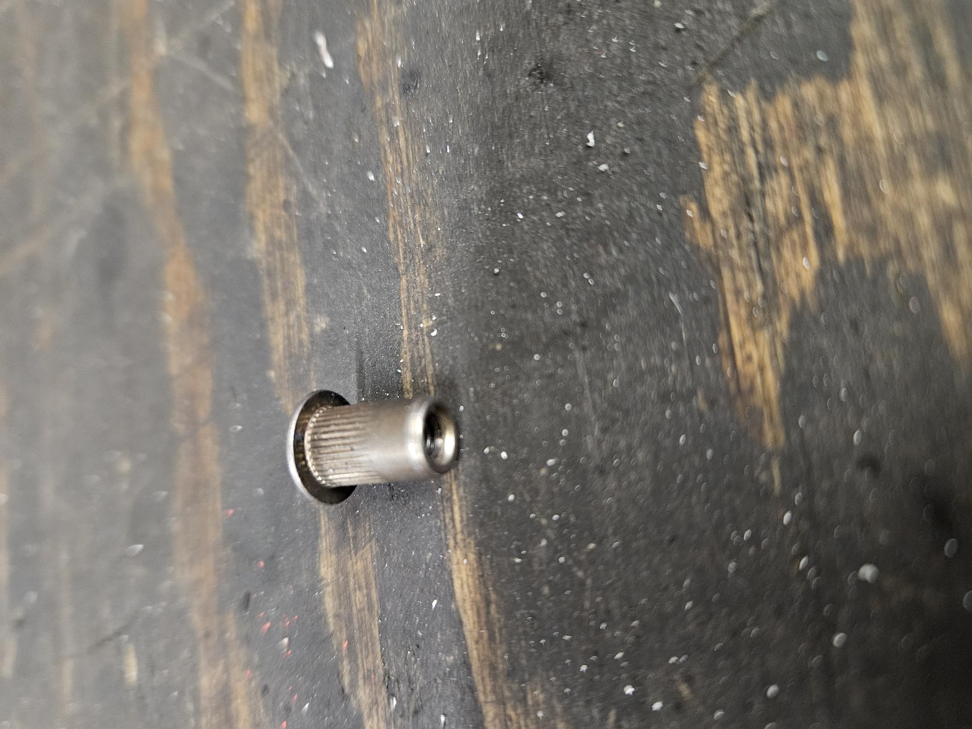

Post by Galligaskins »
I know what you mean about the scarcity and price of them. I repaired mine by drilling out the back plate and aralditing in an M5 shouldered rivnut/ nutsert. Did need a longer screw:
