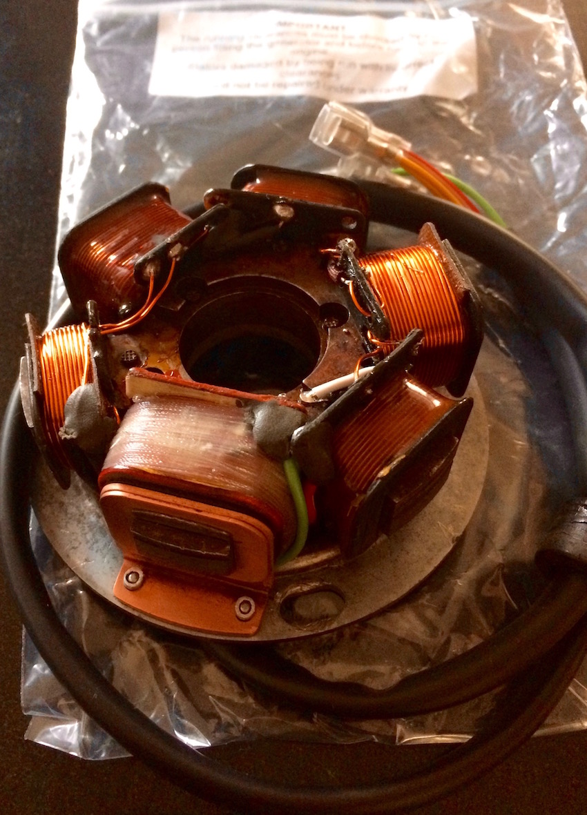

My Stator is back and has had the ignition coil repaired/rewound also to the other coils and the cable replaced.
- stator.jpeg (284.98 KiB) Viewed 8095 times

thanks for finding a route to repair the stators let's us know how it goes.
I have a 500 stator that's only measuring 185 ohms
Please could you measure the resistance of your generator winding as it is now for reference and do you know the gauge and type of wire used. I think the club could invest in some emergency loan type spares as in your situation it would be a shame to miss out on a trip for want of a spare . 20 years ago of course one could buy a new one and have it sent out as happened to Pete Mumford whose Kanguru expired in France. Now there are no new ones only dubious old ones...

I don't think George looks in here all that often so I'll tell you what he told me in a PM. His new ignition coil reads 278 ohms and is fitted and all works nicely.mbmm350s wrote:Chaps,
