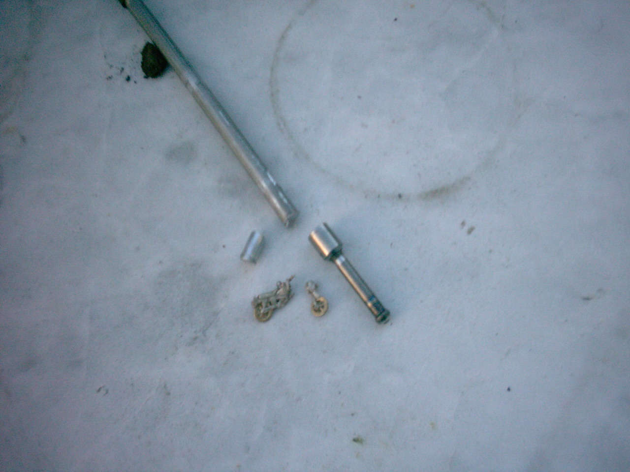

At the concentration I foud this: a broken pushrod. As you see it broke exactly where the alloy part gets out of the steel part.
- IM000165.JPG (252.68 KiB) Viewed 11293 times
Twoo weeks before I began to notice a strange high pling-pling sound at idling. There are so much noises with our motors
that I decided to ignore it, because I could not find the reason. We had great fun to get the little alloy part out, because during our intents it fell down in the cup for the push rod
I changed it and never had problems with the pushrods again. I think it ist not a constructive problem but just bad luck. To me it looks like a infringement that took its time and finaly has broken. Probably it happened because the twoo parts lost their fixed conection. The pushrod fell apart and did not make any noise.
