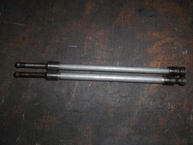

The nice shiny bits to resurrect the Kanguro arrived from NLM but they didn't have any front cylinder push rods. Anyone got one available?

They are probably the same as in all 350's (someone correct me if I'm wrong).
I have one for you...
Posts: 928
Re: Kanguro - Front Cylinder Push Rod
They are the same in all 350 motors, with the dirference that in the early motors they were 7mm, later 8 mm turned down to 7 mm at the ends to fit the steel endings. The old ones were 5 gr. lighter 30 in spite of 35 gr. (the main reason to me apears to be the smaller iron part at the upper end)
The rear pushrods are about 2 mm longer. The sizes over all front/rear:
500 und 250T: 205/207 (therefore the 250T should be 205)
501: 202/204
350: 182/184
ciao
hombre

I have these, they vary a bit in lenght :D but should all come from 350-engines
