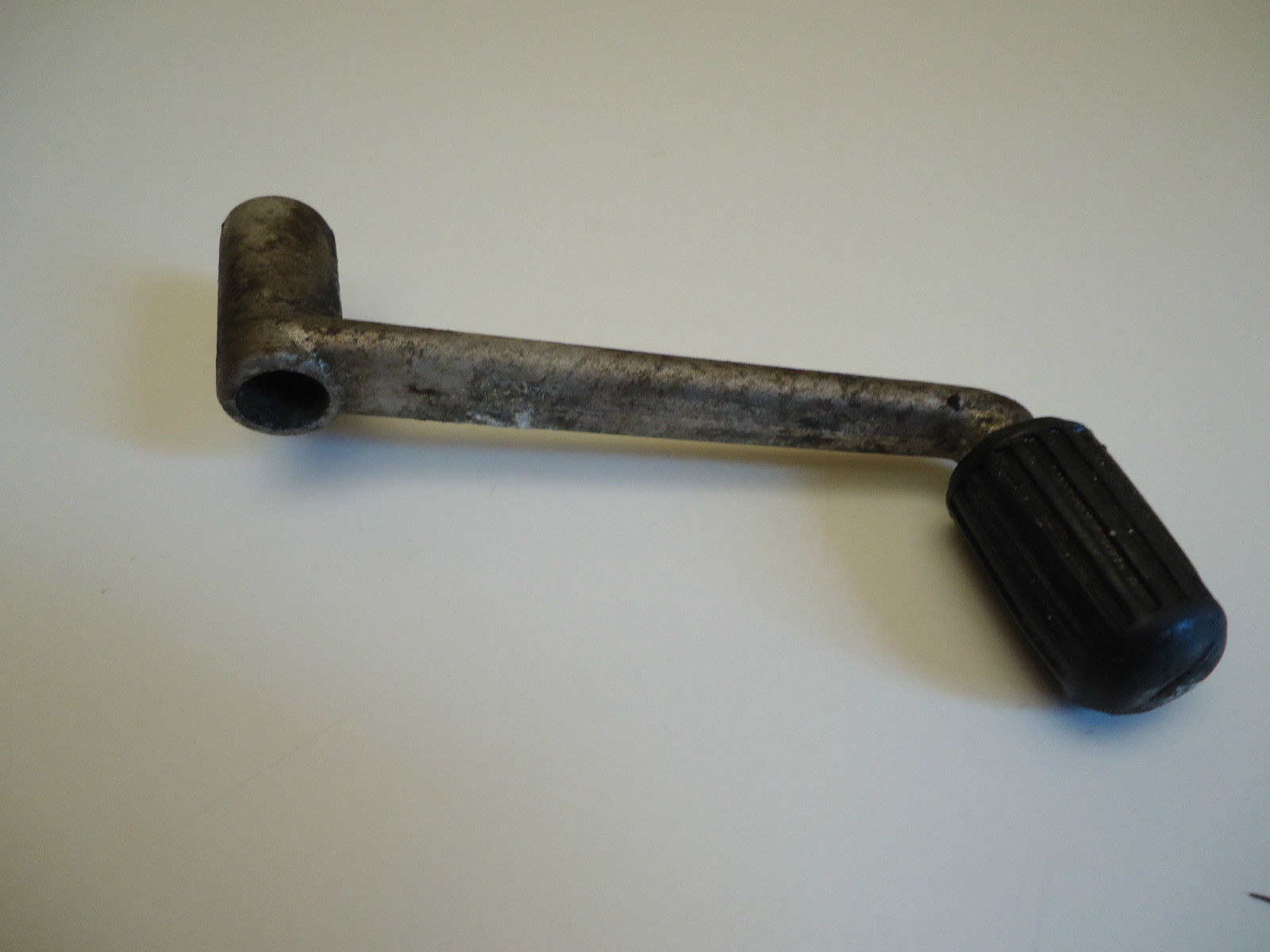

I might have a spare gear lever but it will need attention to the pivot as it is very worn, as they often are. I just sorted the one on the project bike by drilling out to 17mm and fitting a bush. I'll see if I can find it in shed #2.

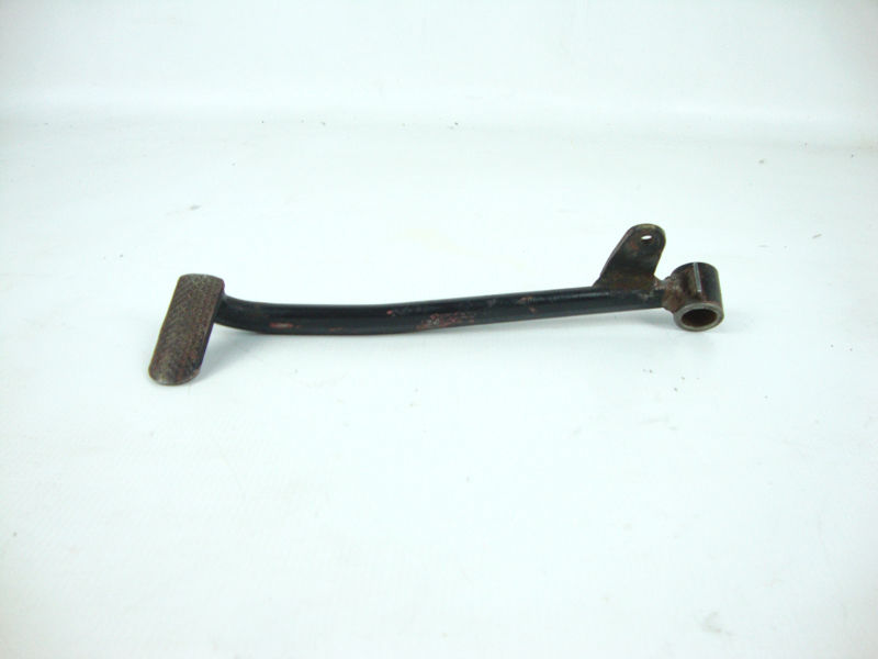

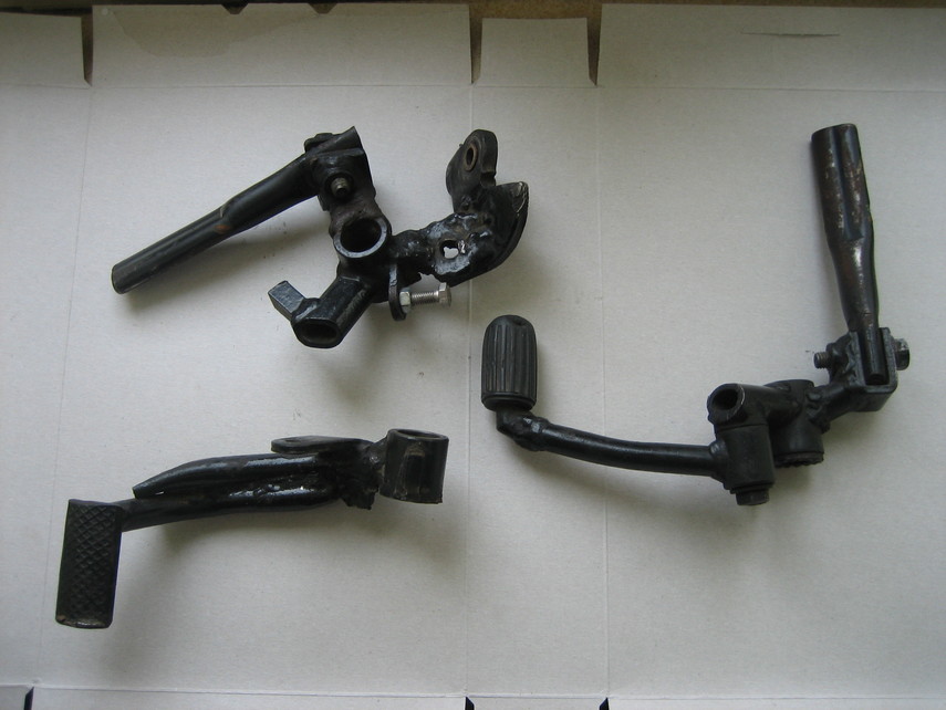

Could be interested in the pipes. As for brake and gear pedal, I think I need these two. (PO used Neanderthal methods to 'modify' them).
brake pedal.jpg (22.26 KiB) Viewed 16029 times
gear pedal.jpg (134.52 KiB) Viewed 16029 times

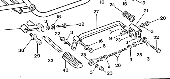

They certainly did so far as the gear lever is concerned. The 2C usually has a 'remote' change with a rod and rose joints. You will need a matching footrest as well as a lever if you want to go back to original. The good news is it looks as if NLM have got the 'trunnion' that goes on the shaft.
Gear Lever.png (68.31 KiB) Viewed 16020 times

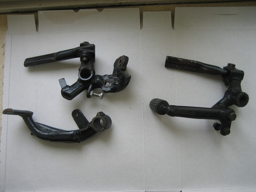

Curiouser and curiouser. Looks like this was a Fred Flintstone Special.
I have all the right parts - but not necessarily in the right order. Looks like the footrests and pedals have been 'converted' into rearsets by cutting and welding (plus the addition of a sidestand bracket which is truly horrible).
So, probably best to get it running as it is before I start putting it back correctly, then I will probably need new footrests, pedals (but not linkage), exhausts and centre stand.
