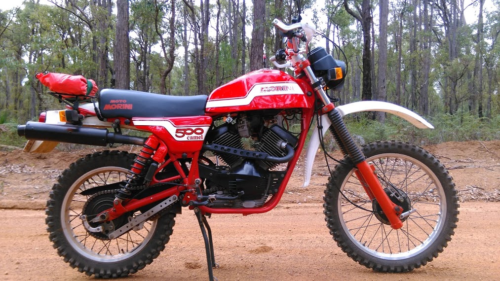

Hi Ian, I am presuming mine is a mk1. It has twin shocks though. I thought the first white tank and mine were mk1 and then the mono shocks were mk2. Anyway, mine has a firberglass tank as well, so no probs there.

Useful little rack on your bike, standard to bike or aftermarket?
Graham
Graham
Re: Wanted, Valentini tank for mk1 Camel.
I got it off someone on this forum !
