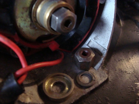

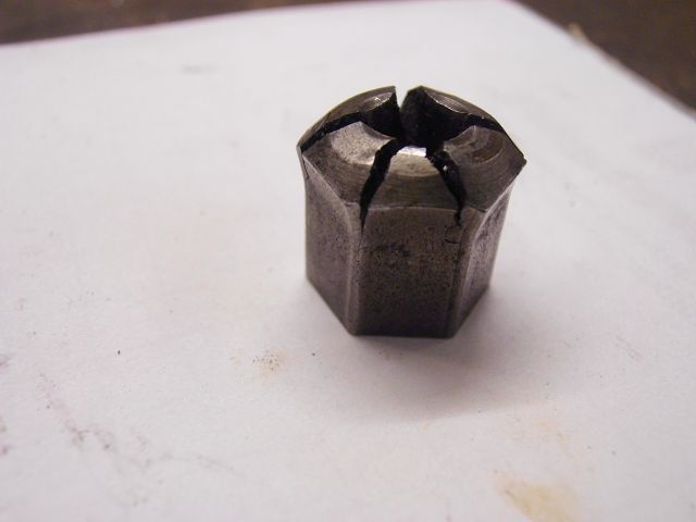

Underneath you need the special washer as usual. But don´t forget to ad also a spring washer! If not, the nut will en up like the one from the foto. The end of the cam will open the square hole for the speedo cable.
This one probably was used without the special washer. But I also have seen them a bit less destroyed when the special washer was used without the additional spring washer.

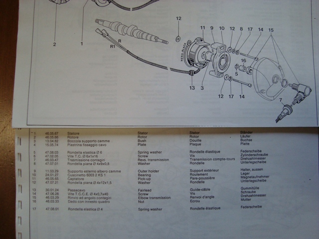

46.03.33 is the same as on the 250 V which all have mechanical tacho drive.

According to the 250 V parts list - 47.07.03 6 x 13mm - special 'dished' washer as Steve pointed out.

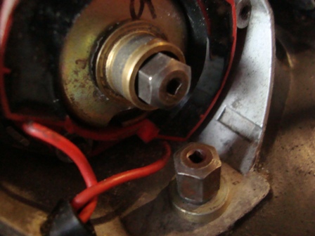

Hi Julian, the dished washer is the same as on most later ignition rotors and there is a larger sleeve/washer on the tacho drives that have an additional support bearing.
Both types use the same drive nut and spring washer.
