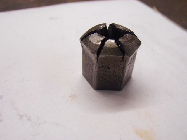

I wonder wether it is the same metric m7 nut as for the brake levers etc. Surely it will be a "fine thread"!
Underneath you need the special washer as usual. But don“t forget to ad also a spring washer! If not, the nut will en up like the one from the foto. The end of the cam will open the square hole for the speedo cable.
This one probably was used without the special washer. But I also have seen them a bit less destroyed when the special washer was used without the additional spring washer.

Another vote for using the correct washer. A jangling about pickup rotor soon leads to no sparks - BTDTGTTS.
46.03.33 is the same as on the 250 V which all have mechanical tacho drive.
