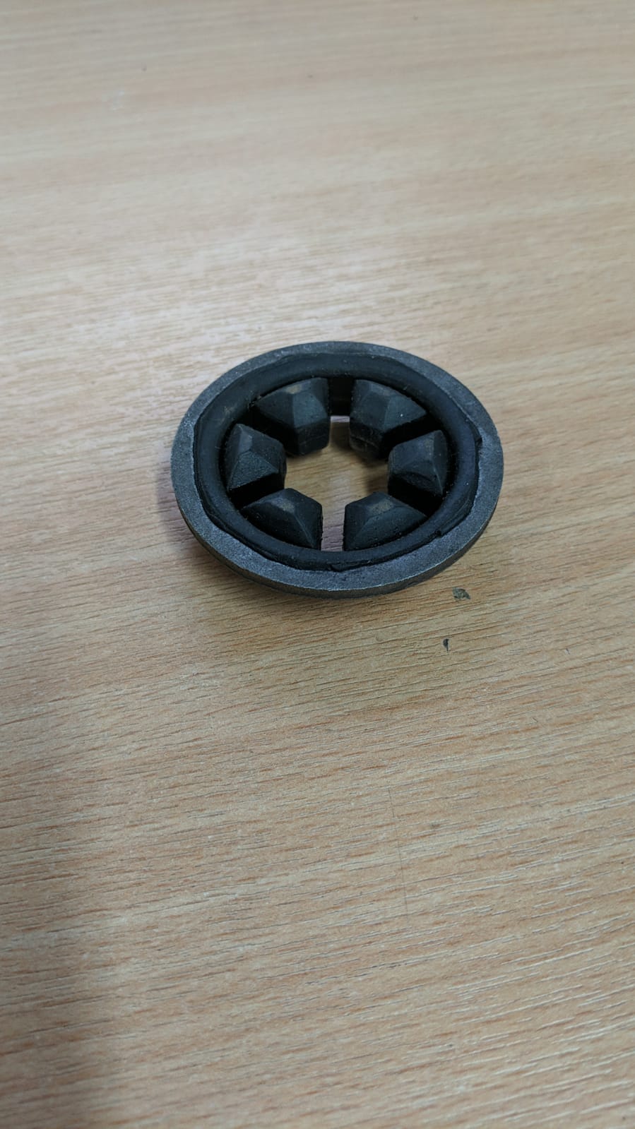

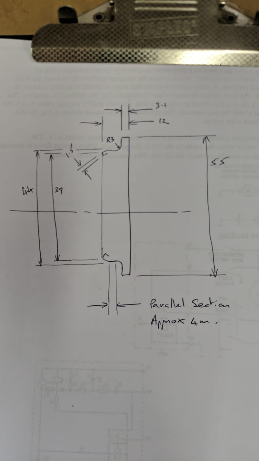

Benjy kindly measured a new cush drive he obtained to refurbish an engine for me. Here are a couple of photos. I've several more of the cush drive from other angles if they'd be useful.
How have you got on with your searching and plans?
Meanwhile I'm asking around to see if there'd be another one available to use for your schemes. Like you, I'm keen to help us find a viable, practical and inexpensive solution.
All the best
Julian
Photo of new cush drive

Dimensions of a new cush drive
WhatsApp Image 2021-02-16 at 14.03.46.jpeg (59.29 KiB) Viewed 6091 times
