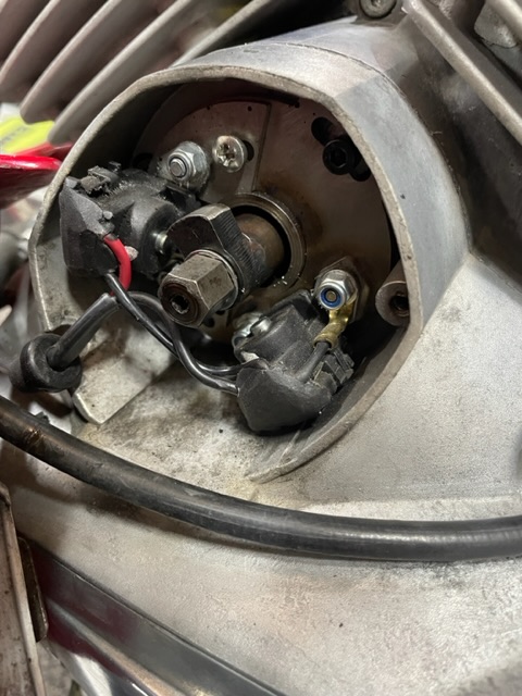

Traced no spark to faulty L/H pickup, anyone have a spare?

Re: 500 electronic ignition
I have a box of spares of these all of which have the similar problems after usage, impossible* to adjust to the tiny clearance needed and one of both of the coil packs is loose, so I would advise not to use, but replace as Steve says with the Luzzi pickup or with a Sachse digital system.

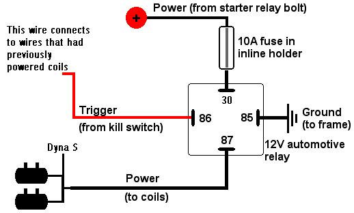

Some great information , one thing to consider is to fit a relay to negate the old wiring and use the old coil wire to trigger the relay then you will get the full 12V feed

- Posts: 2730
This is my next project after I have road tested the bike. I only have 0.1 volts drop from battery to coils at the moment, but more testing required. I took the +12 volts from the switched 12 volts at the fuse box and used the block under the front of the tank as a connecting point for the SWF loom. The system is designed to use the fuel tap supply at the block. I can easily fit a relay into the system. I also fused the system as the fuse behind is the fuse in the cylinder.
Maybe a diagram is required! The kill switch, obviously, is now back to front- off is on and run is off. That'll confuse the buggers!

Glad to hear you are having success with the SWF system. I had high hopes for it but struggled to get the timing right. The only adjustment was by rotating the trigger rotor on the camshaft. I think it would have been better if the back plate had adjustment slots like the original parts. Anne did send replacements and was patient with me-up to a point. His final analysis was I wasn't able to kickstart it fast enough! Obviously not the problem here as with the unit set for a late spark it would start very easily. When I strobed and adjusted the max rpm advance I got a low RPM advance that was way off and the bugger would just kick back! If you are finding it easy to set up then perhaps the set is now modified in some way?

It'll be a while yet, I am recovering from a tendon operation and can't get my foot on the foot peg, although things are improving.
Steve, I agree with the rotor problem. It would be better to use the existing key on the cam and slot the circuit board. The ease of getting the timing correct (set pms1 on compression stroke and turn rotor until red light extinguishes) but holding the rotor whilst tightening was a problem.
