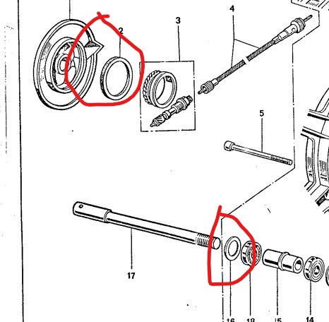

I find I am missing the washer part No. 43.05.49 OR what dimensions is it?; and the speedo drive seal part No 43.07.15 (assume I might get away without this, but debris gets in?) OR again its dimensions.
If anyone can help, thanks

I may have one. Is it for the large diameter shield (the casting with the ’beak’) or the smaller?

The part 16 43.05.49 is just a shield for the usually fitted unshielded bearing, if you fit new metal shielded bearing then its not needed, notice the other bearing is described in Italiano as schermato this means shielded.
If you already have fitted an unshielded bearing then its best to fit a shield, I will look for one if you need.

Have fitted shielded bearings thanks. So you reckon all will be ok? Many thanks

Parker3865 wrote: 01 Dec 2023 17:10 Have fitted shielded bearings thanks. So you reckon all will be ok? Many thanks
Yep, no problem part 16 not required with ready shielded bearings.
