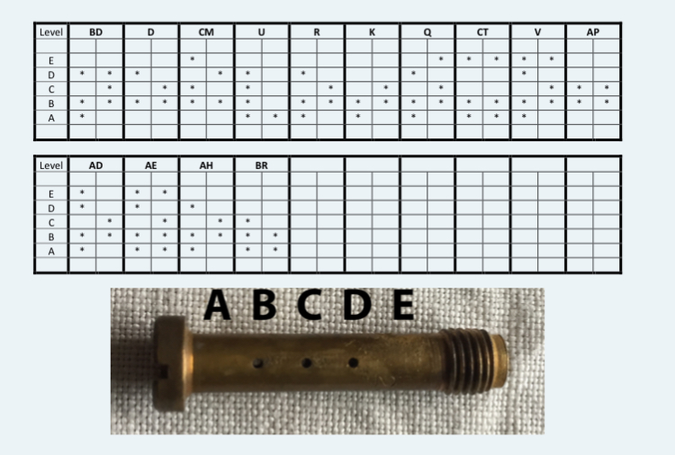

sorry for late reply - I have replaced all the jets in my VHB carb except for the emulsifier which appears to be no longer available anywhere in the universe.
I have been informed that they do in fact wear which can effect mixture and acceleration I have the original from the bike and another one I picked up locally and ordered the nearest that Mdina had left in stock, so its going to be a bit of trial and error this Spring to see if I can get the mixture right. The bike is not stock in regard of inlet and exhaust but I will dial it all in using the usual methods.
A contact in the Netherland tells me that someone in Germany can make new ones from scratch but I have yet to here further from him, it looks like watchmaker stuff to me!

You can get an available spec 260 then drill out 0.8 mm holes, then ream with a 2.60 reamer to make a U pattern.

I think 260S are the ones without holes and which you can use as a good basis to make every 260 you want it to be

3potjohn wrote: 05 Mar 2024 08:58 You can get an available spec 260 then drill out 0.8 mm holes, then ream with a 2.60 reamer to make a U pattern.
John this is a useful table but it omits a little detail, not all holes are 0.8mm across all emulsifiers.
For example BR has 1.0mm holes. So we would need to double check the U hole sizes.
A table was in La Strega if i remember correctly with the hole sizes correctly identified.

According to the article in La Strega the U has 0.8mm holes.
The CT has holes of 1.0mm at A and B
If adapting other tubes excess holes can be plugged with solder.

mbmm350s wrote: 09 Apr 2024 17:31 According to the article in La Strega the U has 0.8mm holes.
The tables in La Strega certainly worked for our 31/2 when we bought new atomizer tubes and modified them by adding holes in the right places. Appreciate your carburetor is different but as a general principle its a good way forward.
