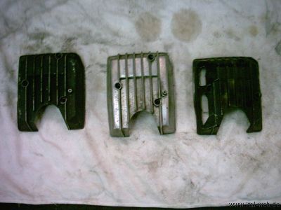

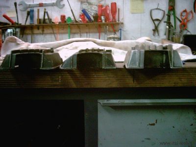

Her you have the three types of rocker boxes
on the left the old ones, in the middel thee usual ones and on the right 501
now on the left first series, in the middle 501, on the right the normal ones

Hi, the later rocker covers (with the banjo type breather outlet) although having the same crows feet spacing they also have additional cooling fins on the inside.
Can't comment on the very early rocker covers: but aesthectically they look better?
