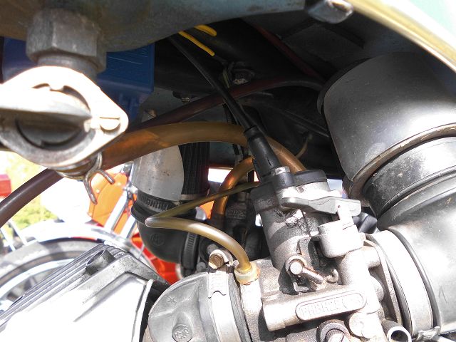

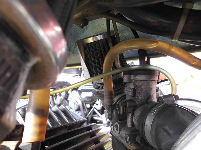

Rocinante wears nearly the same carb-configuracion as Pedros bike N°2 with original 350 filterbox (with or without filters inside). The tubes of cause have to have the size of the 500. She wears 2in2 and the silencers are the old Lafranconis (doblefolded) from the 350. I opened them a bit to fit on the 500 tubes.
Dulcinea (still running in the motor) has type K+N filters. I´ve cut original 500 rubbertubes (carb-filter) where they are folded an put the K+N on them. They are well hidden under the tank and wind doesn´t seem to influence. The exhaust sistem is a handcraft rised 2in2 that allows fine respiracion without beeing extremly noisy. The carb-configuracion is close to the original 501 (Camel, Excalibur) except the main jet. But still not aproved.

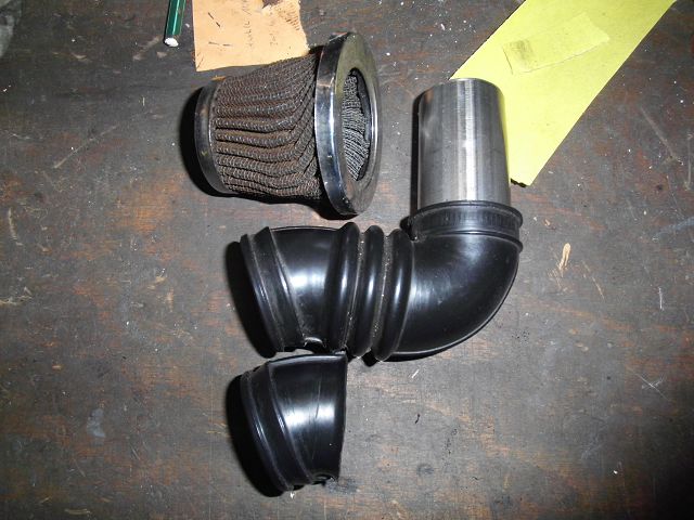

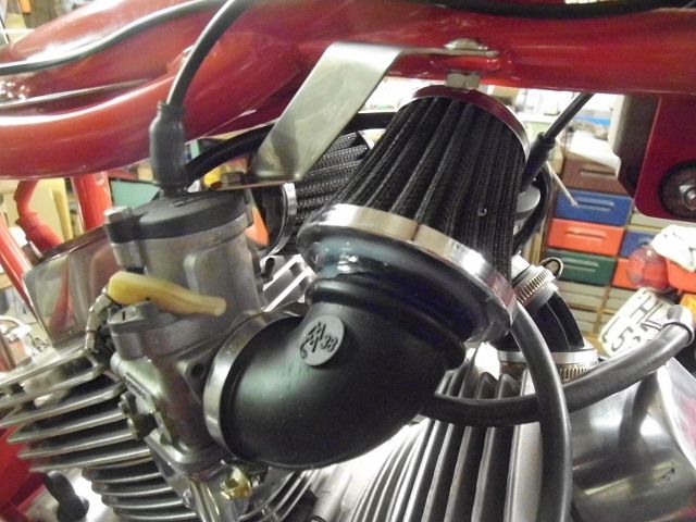

Hartmut resolved the problem of the air (especialy of the rear cilinder) this way:
He uses the rubbers of a Camel/Excalibur 501 (carb-filter) adding some kind of tube inside to fix the K+N. The alloy windshiels can be turned.
The advantage of my solucion ist that I took of the original rubbers from the K+N, who weigh quite a lot, stressing the inletrubber (carb-head). You can fix the filter in the first fold with some silicone. Anyhow one shoud support the carbs. The inlet rubbers for the 501 use to crack easily (at least that´s my experience :evil: )
