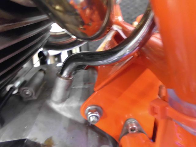

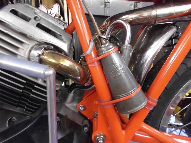

I´m struggeling as well a bit with the breathing system of my new bike Dulcinea (but without mayonaise problems).
Rocinante (501 K) wears the old system, an odd plastic tube that originaly ends under the seat, which I prolonged to the rear end of the frame. I put inside only one of the originally two baffles and it works fine for many years like that. The tubes of the rocker cases ending to free atmosphere somewhere underneath the motor.
Dulcineas crankcase breathing system is a bit different because the rear exhaust pipe that does not allow a straight upward breathing tube. I´ve put a somehow sofisticated metal tube with 10 mm diameter (inside) thet leads to an old oilcan. In this oilcan I´ve put a ventilacion tube to atmospere of only 5 mm. This is obviosly to small, oil coming out from the clutch, behind the generator and pickup. I´m going to give it a bigger ventilacion tube of 15 mm. The 10 mm tube from the crankcase to the oilcan has no baffle inside. My calculacion was that the 10 mm diameter would give more or less the same passage as the original baffles (original breather tube is 18 mm). The metal breather tubes of the Enduros have about 15 mm without baffles inside leading to the breather box. I hope with the bigger tube on the oilcan the system will work. I´m gonna see it, when I ride to the danish meeting at Sören 5-7 of may :wink:
The mayonaise problem of penman I really don´t understand. Where does this water come from after changin the oil several times? :roll:

It would be interesting to perform a dissection on a collector/breather box. I think the labyrinth baffles provide a large surface area and perhaps some reduction in gas velocity without creating as much back pressure as a smaller diameter plain pipe. I'd say you definitely need a larger outlet for a catch tank. For 'racing' I route my rocker box and crankcase breather (with two baffles) tubes in to an old plastic oil bottle stashed under the seat behind the left hand side panel. The gap around the gathered tubes where they enter the bottle gives an effective ventilation area of far more than 5mm or even perhaps 15mm.

Posts: 927
Re: Mayonnaise
Without the oilcan, only with the 10 mm tube it was only the clutch that was loosing oil. The motor is new to me, so don´t know if its leeking over there anyhow. And I´m not sure yet about the compresion rate. But you may be right that the tube should be wider. I thought about it the same way, the labyrinth rises the presure only for a few cm. But this one was easier to bend, it´s from underneath a washbasin, cromed copper, so I´ve decided to test it. I´ve tried to bend a normal size plastic pipe but could not do it propperly with the angle that I need. I hope that it´ll work with the definitive new rebuild motor that will be mounted after the danish meeting. If not, I´m gonna modify a endurotube. Will keep you informed :wink:
