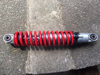

Hi Roger
At Cadwell, Stewart was less than impressed with my rear shocks at scrutineering, deficient damping! This is on my 500 1980 Sport.
As I managed to persuade Stewart that I wasn't quite up to Rossi's standard he allowed me out. I had previously got a pair of Hagons which I should have put on and which I fitted the following week.
This means that I have a pair of shocks sitting idly under the bench. I believe them to be original but better minds than mine can probably confirm from the picture.
Trust this assists.
The measurements are as follows:-
I) Centre eye to center eye length of shock, removed from the bike. 312mm
ii) Outer diameter of spring. 58mm
iii) Distance between center of lower eye to bottom of spring (for chain guard clearance) 70mm
iv) Diameter of spring wire 8.2mm
v) Diameter of shock's top and bottom mounting bolts 10mm
vi) Is there any off-set for the bottom eye or top eye? No
Trust this assists.

That looks like an original shock. I still have original shocks on my 500. I have contacted Ikon here in Oz; if they want to come to my place they can take their own measurements, or I might be able to take my shocks to them. I imagine that if they want to make replacement shocks for the 500, their own measurements would be best.
