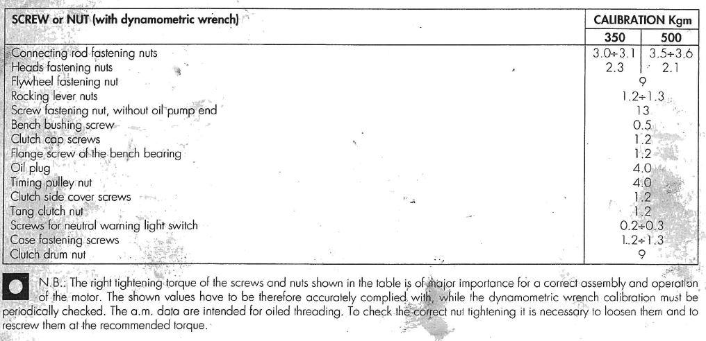

I've just been looking for the torque wrench setting for the oil pump drive gear nut - the one on the end of the crankshaft. I'm sure it'll be in the blue book somewhere, but I'm blowed if I can find it! Anybody help me here? Thanks!
Joe

penman wrote: I've just been looking for the torque wrench setting for the oil pump drive gear nut - the one on the end of the crankshaft. I'm sure it'll be in the blue book somewhere, but I'm blowed if I can find it! Anybody help me here? Thanks!
Joe
Hi Joe, I was about to say it's all together on one page-but I looked and it ain't! Found it on page 59 though. It says 4.5 to 5 m/kg which a google search says is 33 to 36 ft/lbs.
It does need to be tight for obvious reasons, but it's worth checking the locknut is still locking. The basic idea is that when the nylon or whatever it is insert starts to engage it does prevent the nut from running freely on the crank thread. I think NLM has new ones too.

In the manual of 5 languages they say 13 Kgm for that nut, the tightest of all!

Thanks for the info guys! Curiously that torque figure has now appeared on Page 59of my copy of the Blue Book, it definitely wasn’t there last time I looked!
For most purposes, mkg x 10 is near enough equal to Nm as marked on modern torque wrenches. My old Norbar torque wrench has mkg marked on it. I think 13 mkg can’t be right for that very slim nut. Can it? Anyway, I’ve gone with 36 Nm and that was difficult enough!

The last of the manuals (the 'cagiva era' one for the kokusan engines) has a handy torque chart in the back.
Whilst I wouldn't guarantee the torque figures didn't change over the years, it's a handy cross reference, incase any of the figures in the blue book were misprinted, or they changed the setting due to some kind of issue identified in production.
The Cagiva manual agrees with 13kgm for the oil pump nut, so it's probably right. As you say, that's f-tight, but bear in mind that is what retains the crank axially and provides drive to the oil pump. I don't specifically remember what I did when I rebuilt mine, but do know I followed the manual, and I have a feeling I borrowed a torque wrench from work as mine only goes up to 100Nm, and possibly waited until the engine was in the frame to torque that one up...
A copy of the torque chart is below. I would advise the specified 13mkg, unless anyone on the forum suggests to the contrary.
The full Cagiva era engine manual is in the club's members area for download, and is a good book even if you don't have a kokusan engine.

and thanks for the torque settings list. 13 mkg (~130 Nm) is not the answer I wanted, particularly as I have now reassembled the primary, clutch, etc. Neither of my torque wrenches go up that high and the tool I got from NLM for the oil pump nut is not suitable for such a high torque, so I’ll need to think about this. Obviously I don’t want to under-tighten it.
Just thinking aloud for a moment, I wonder why it would need to be so tight? The blue book figure of 4.5 to 5 mkg is already tight by motorcycle standards - and it’s a nylok nut. The blue book is quite specific about the torque figure, I doubt if it’s wrong, though I guess it could easily have been changed for later engines for some reason - and that’s a very thin nut to hold such a tight torque.
