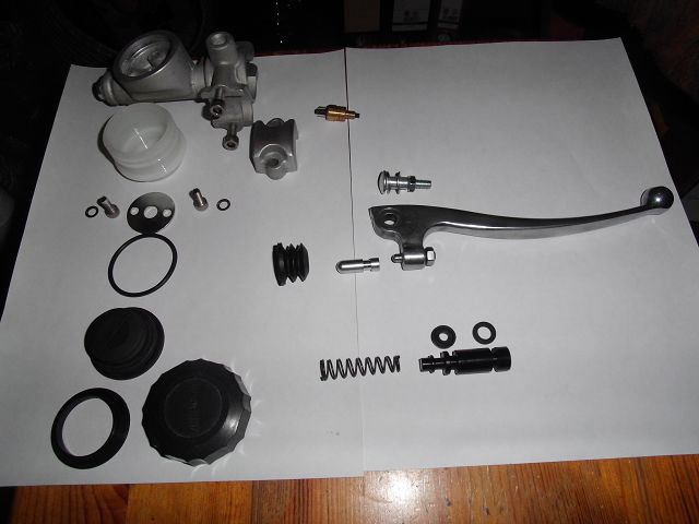

For years I had 16mm mater cylinder for my dobledisc. Then I tried a 13 mm Grimeca mastercylinder with two disks and stainless steel tubes. A two-finger-brake!
Posts: 930
Re: 500 Front Brake
As I`m going to change Dulcinea from the 230 doblesimplex to two discs I was looking for the same master cilinder as I have in Rocinante and I could find one :P
It´s a 13 mm Grimeca with the tank a bit inclined for the use with clip ons. It´s quite small and apreciated for folks riding on circuits because it fits well fine behind the fairings.
It´s this one

Is that perhaps the Grimeca master cylinder that was otherwise used on Kanguro models? Not sure if they were 13mm, but I do know they looked very similar, with the plastic inclined tank.
