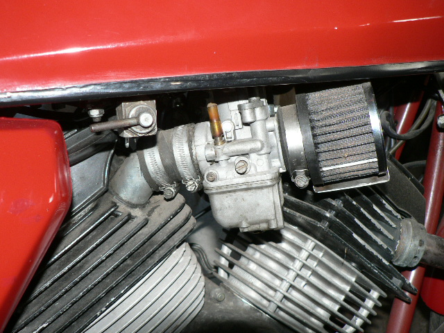

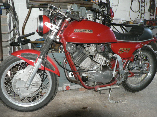

I had a spare pair of unused 507 barrels and heads and after reducing the barrel spigot fitted them to a 5speed bottom end. I do not like the rubber inlets so made up metal curved inlet tracts which screw into the head, so the inlet duct is 28mm all the way down to just before the valve head which tapers to increase gas velocity. As you cannot get the head and barrel off the back cylinder once fitted, should the matter arrise, I shortened the return loop tubes to the under side of the seat tubes and moved them rearwards as on the 500 frames and re welded. This also give, you more room for the rear exhaust even though the frame is narrower than the 500 frame. If you do not do this mod then you have to spend 1/2 an hour whipping the engine out to take the back head off. It is also less fiddly checking valve clearances.

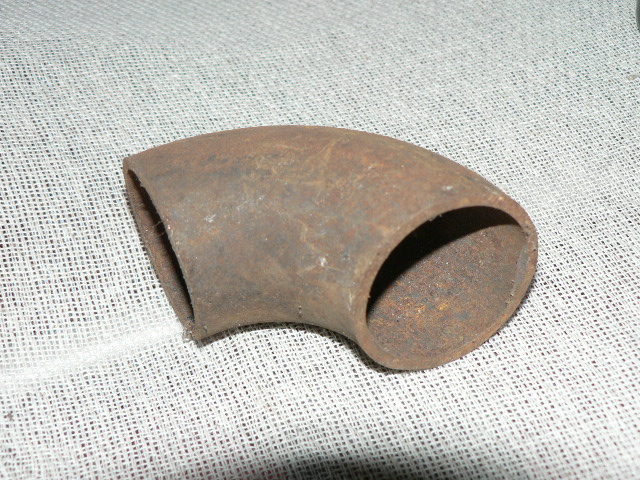

Re: 350 500 motor conversion
I had a pair of bent fork stanchions 35o/d which are the right size onto one end I screw cut the correct thread, I then obtained a section tube 45deg and cut that in half to make a 221/2deg section and with the screw cut straight tube screwed into the head then tacked the bent piece to get the right angle. Removed from the head welded the tube together and then waded another short piece of for stanchion that allows the carb to be mounted into a rubber tube and rubber tube onto manifold so there is no step giving a smooth inlet down to the valve. If you want see the result let me know.
The first photo is close up shewing the manifold screwed into the head, the second the type of section pipe that I used. I must have used a 90deg pipe cut into two to create the correct angle for the slope of the barrels. The bend is from an engineers suppliers and is thick walled pressure piping used for high pressure factory installations, the wall thickness is about 4mm. When joining the bend and the 2 straight sections I formed 45deg chanfers on the straight sections on the lathe to obtain a good weld joint. You have to screw the threaded section into the head to get the correct position for the curved section and tacked, removed and welded up. I then had the manifolds bright zinc plated. You can see that the carb is connected using a rubber connecter, the carb spigot pushed in to mate with the manifold so that is flush to the whole tract is smooth bored down to the valve. I did intend to have a long increasing in diameter inlet before the carb but found the filter too close to my left knee cap and already having had one knee cracked whilst racing my Aermacchi at Cadwell in the sixties, opted for the short one as you see. Last photo is the bike as a whole. I could make one for you but ideally I would need the engine to set up the correct angle for the carb. If you should decide to do this improvement and have the original stubs in the head which are seized then find a local tool makers who may have a spark eroding machine that can cut the original stub out without damaging the thread in the head.
So Harry, even if i don't do that clever modification, how does it run? A 2 into 1 and K&Ns (what jets?) does it rev well and no running faults??
I built up the engine to deliberately provide torque in the upper mid range so left the standard 500 cam, but on hind sight think that the 350 sport cam would be the better cam with the slightly greater overlap. I did not want one of the big overlap cams in as although greater power would be gained it would narrow the power band and move it up the rev range which for a road bike is wasted. It was built to provide fast cruising and quick recovery from bends and cars in the way, without have to play the gear pedal like an organ. The problem with the standard exhaust is that the two halves the engine are not matched, one shorter than the other, so with 2-1 the pipe lengths are equalised and have the benefit of creating an extracted effect on the exhaust gases. The carbs are set up as for the standard 500, I think, without going through my note books and stripping the carbs to check.
She pulls from about 2000 revs without any hesitation with torque coming in at around 4000 with a surge building progressively to my own set max revs of 7500 owing to the number of 500 motors I have built for people over time with knackered big ends, so rarely have any need of going over 6500 if I have to. Once she is on full chime I do have to admit that the exhaust is reminiscent of the 500 Honda four that Halewood used to ride, made my hair on the back of my neck stand up when I first encountered it after a sort running in period and I do have to indulge at least once or more when out. I have generally gone up on the gearing as i do not carry passengers and if knowing that my work would be cross country then would go down o a 40 rear sprocket from the normal 44 as on the 5 speeders without any problems with cruising generally on A and B roads in the 70 to 80's and as I have said not having to change gear unless speed drops down below 50 and then only into 4th for a quick cruise recovery. K&Ns I have no problem with. I did have a SEI with K&Ns and the only problem I encountered was in very wet weather, rain dripping off the tank into the filter and draining into the float causing miss firing. This I remedied by shielding the top of the filter with S.S shields. If you mean do they affect carburation, particularly with the back pot, then the only time I did experience adverse effects was when I built this bike up and wanted to take it round the block on test with open bell mouths which caused the rear pot to eight stroke owing to the air pressure pressuring the float chamber at anything over 30ish mph in any gear.
Starting once warm on the electric start in no problem though when cold it does struggle but starts 'first kick' and settles down to a tick over at or around 1450 revs, no hesitation on opening the throttle and it starts straight to tick over without any throttle. I do run iridium plugs though, which do improve starting and general running over the standard plugs. I have these at great expense in my proper cars and I did notice an improvement in tractability and performance. Without checking I think I may have fitted 350 transducers with the pick up set to a 500 max advance at 6000. I suppose I should fit the 500 ones I have kicking about and see if it makes any difference. I did one morning spend half an hour trying to start the thing with starter motor, kick starter - had to fit the lever and bump starting to no avail. Return to the garage took the starter cover off and found that the rubber cam belt was broken. Fitted a standard industrial belt and had no problems since. If you look at the overall picture and down by the front of the drive, there is a small black canister with braided pipes leading to and from that canister to the drive side cover. It is a remote full flow oil filter, as when I stripped this engine bottom half and taking out the grub screws at the end of the crank pin, was at first puzzled at how the Italians had drilled a stepped hole. I then realised that the oil gallery was filling up with crud, owing to the centrifugal effect of the crank going round and creating a sludge trap. My origin SEI ran its big ends because of the oil feed to the bearings gets closed off. This happen before I bought it in bits from the first owner with about 30,000mile on the clock and changing the oil even 2500 miles. I did this mod on that SEI as well. This adds to the reliability and usability of the bike and this modification was first tried out by a chap in the Dutch club.
If you want anymore specific information then let me know or really want me to check the carb setting, then let me know.
