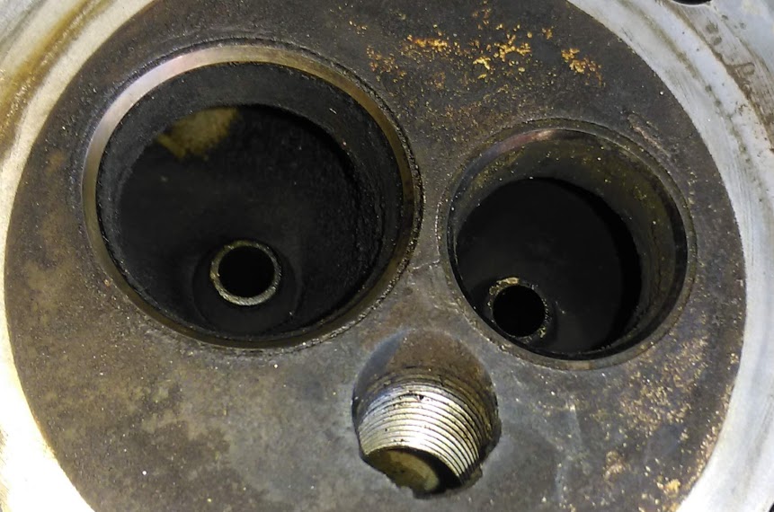

Unfortunately I have a small crack in one head between the valve seats. That area is slightly raised as well. I have a guy that said he could weld it but thought I would ask here, how successful is welding these heads. (500 Camel) Is it a short or long time fix ? I also need the exhaust thread fixed. Read story in my Off Road Bikes thread.
Also, I don't seem to be able to find a source for valve guides. Mdina don't seem to have any. Anyone know where to get some ?
Alternately, I could be in the market for a good 2nd hand head.

Cracking between the valves on the 500 heads is unfortunately common.
One method is to create oversized valve seat inserts and overlap them, but have seen them successfully welded too.
A couple of (sorry not very good) pictures of mine on this post:
viewtopic.php?f=34&t=2499
Regarding guides, Alex Lussi had new stock: alexluzzi@gmail.com

Have a rumage around at lazer welding, it is very unintrusive and the depth of weld can be varied and the heads do not need to be stuck in an oven to reduce distortion. It is now the chosen method for delicate die molds and other delicate work. There is another method that is now coming into use which is cold welding that along with lazer is becoming the norm in proper engine repairs for aluminium alloys and cast iron.

Thanks Paul, I found the guides.
Harry, I will look into Lazer welding down here.
Tom, thanks for that info. I may suggest to the engine rebuilder to do a valve overlap. I will see what he says.
I spoke to Brook Henry from VeeTwo (Ducati expert, look it up) and he said overlapping the valves could work.

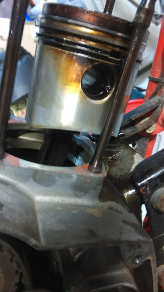

I did read that the 500`s are meant to have dowels between head and barrel. Mine does not ?? Is this a worry ?
I got the front barrel off tonight before running out of time. I does not look scored. But I have not had a good look. Had to make up a gudgeon pin removal tool. How do you guys think the front piston looks ??
I have a feeling I may need to tilt the motor to get the rear off.
I was going by memory. I would have double checked before actually doing it. Thanks Paul.

Gilardoni barrels/heads have dowels.
