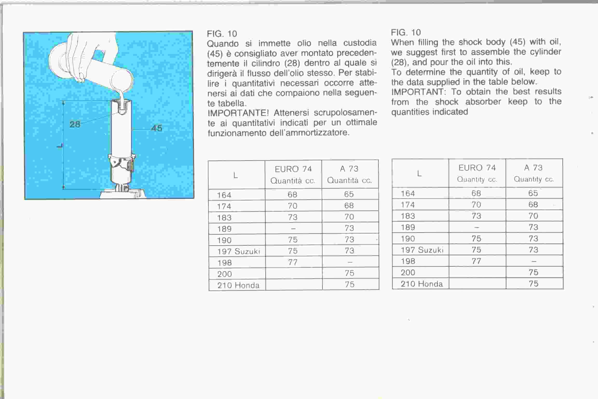

Hi all,
36 years ago I rebuilt a pair of marzocchi rear shocks. I'm doing so again, but for some reason I can't remember the amount and weight of oil I used :?. It's for the basic grey bodied units with the 9 mm damper rods.
Graham.

Trust this helps.

Thank you, that indeed helps
