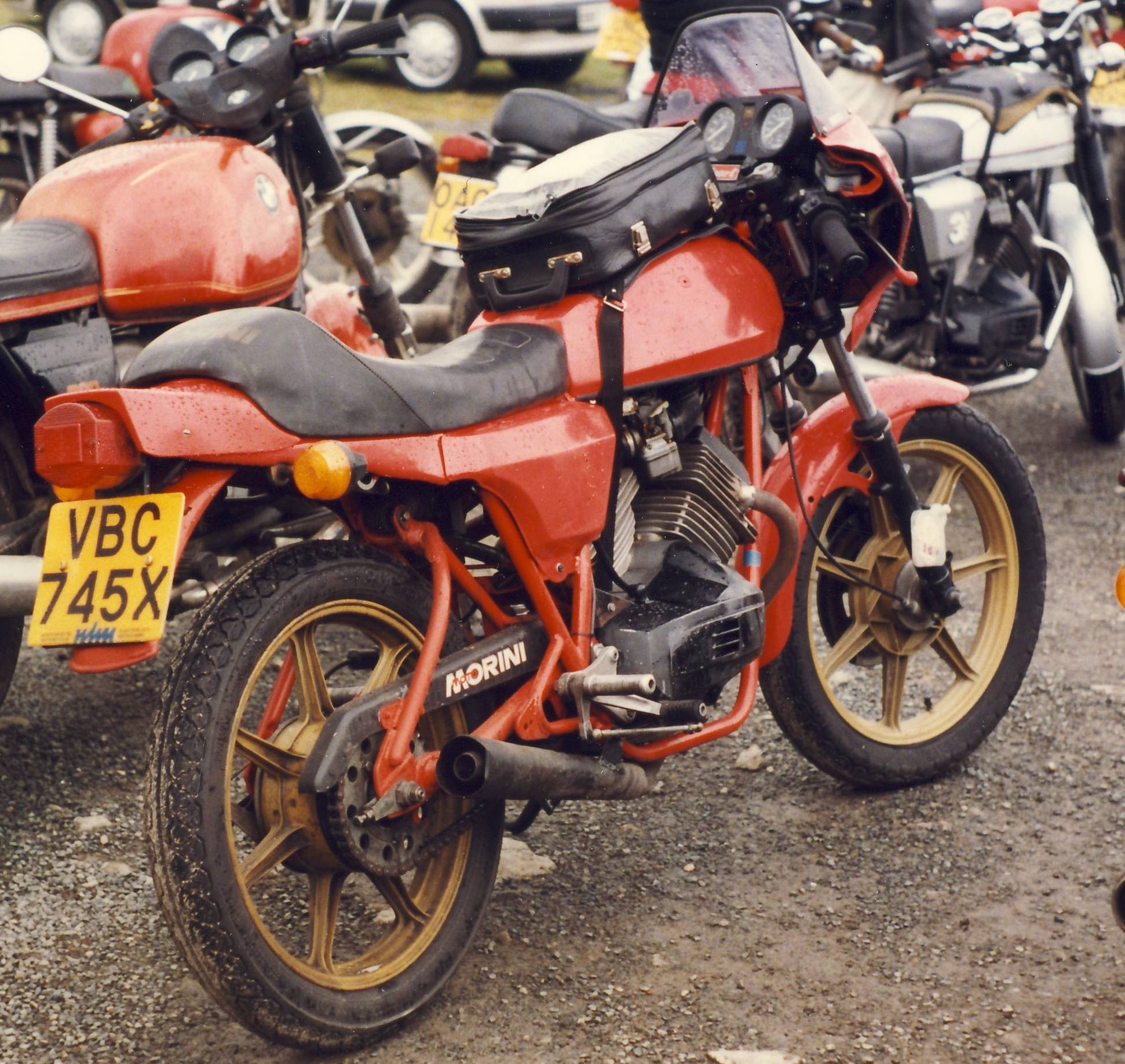

1) If having working and functional speedos and revcounters is what you're after then I've previously fitted the instrument cluster from a Honda Super Dream 250. I used them on one of my 350 sports in the mid 1980's (it's the same bike I fitted a Yamaha LC monoshock to, see photo). I've since bought another complete instrument cluster including the ignition switch and key from the same model for around £30 - £40 (not much anyway) for when I want to do something similar. They're good enough in terms of accuracy and easy enough to obtain (there are well over 100 results listed on eBay.co.uk currently).

Trimmed photo of VBC745X monoshock
