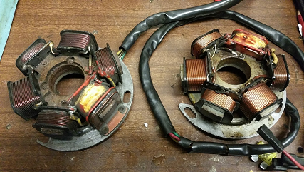

left is 500, right is early 350, sorry not for sale.
PM me if you want high res pictures of the 500 one.
