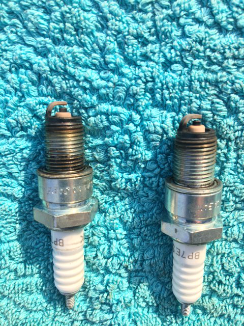

Hi Canuck, I hope that you do not mind my piggybacking onto your carb thread but I am hoping that someone may be able to help with my 500 carb/ignition.
Currently my 500 seems to run OK but I feel that it is a bit slugginsh - struggles to reach 95mph and seems to me to me a bit slow off the mark, especially from a standstill when the engine seems to bog down a bit at small carb opening. Since I bought the bike a couple of years ago now, I have renewed all the jets and needles and float valves so that they are as per the manual (PHBH 26). I have also replaced the air filters with the standard filters, purchased from either NLM or Mdina, can't remember which. This has made the bike run a bit better but I am not impressed with the speed. I took it out again for a ride last w/end and on my return I removed the spark plugs (NGK BP7ES) - see photo (LH plug is rear cylinder) - and to me it looks as if the mixture is a bit on the lean side - the centre electrode is a light brown, almost beige, but the ground electrode seems to be OKish but a bit pale, in my view. If it is runnimg a bit lean, has anoyone got a suggestion as to where would be the best aspect to start changing, needle height for example?
I believe that the valve timing is OK but when I renewed the cam belt I felt that the timing marks did not truly line up as per the manual, there was approx 1/3rd tooth out from the manual's stated positions. Could this be the cause of the sluggish performance? The timing marks were aligned in the same positions as when I removed the old cam belt. I do not want to understate the performance but I would have expected a bit more form a 500cc bike of that age (1981).
I have checked the ignition timing and that seems OK - it was somewhat retarded when I bought the bike - and it uses the red spot coils. I have a Sachse ignition to fit but before I do that I would like to see if I can coax a better performance out of it before changing as that will just add another variable into the equation.

- NGK plugs
- IMG_3496.JPG (402.24 KiB) Viewed 8584 times

Its hard to say from the photos but I would say those plug colours look pretty reasonable actually.
You mention the timing marks being about 1/3 tooth out- The bottom pulley has multiple keyways in it so you can pull it off the crank and rotate it until you find a position that gives you the correct cam and crank timings.
